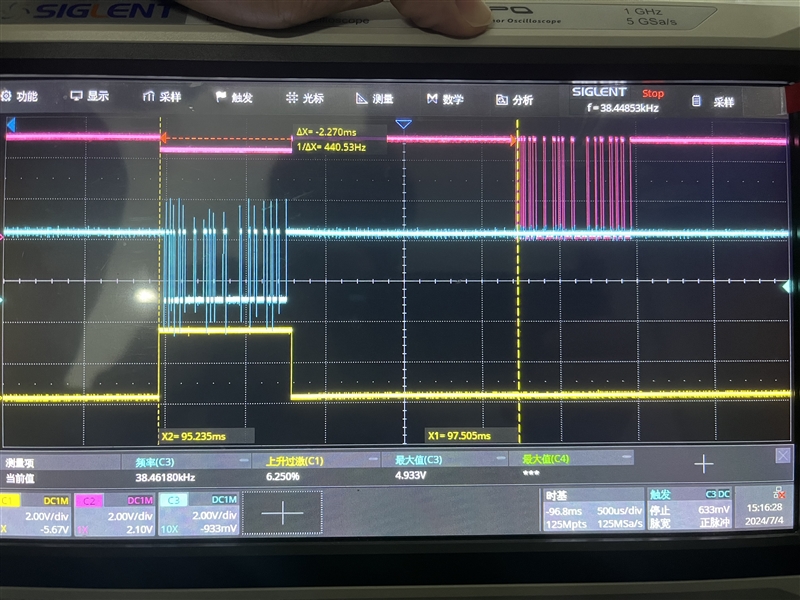

issue description:
        After sending data via RS485, the direction signal is pulled low too slowly, causing the received data to be incomplete.
The blue pin is for transmission, the purple pin is the direction control (high enables transmission, low enables reception), and the green pin is for reception. Normally, the direction control should be pulled low immediately after transmission, but in this case, it is pulled low too late, during the middle of reception, causing some data to be missed.

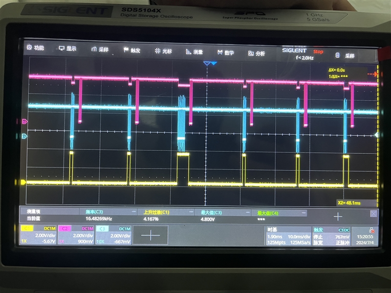

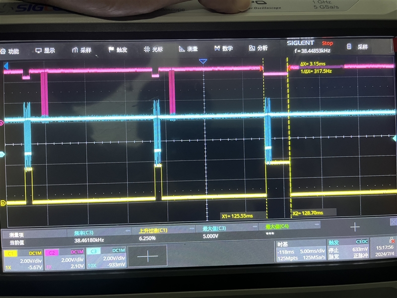

    The purple signal is the receive pin, the blue signal is the transmit pin, and the yellow is the direction control pin.
    This is a normal waveform:
    This waveform shows the problem; the direction of the quotation marks changes very late:
    There's another image for reference,

    Thank you very much for your reply. I feel that it has little to do with the kernel version.
    I added some print statements to monitor the execution time and I noticed that sometimes the interrupt function is executed very late (the direction signal pin is pulled low during the interrupt). Given that we are operating on an RT kernel, is it possible that the scheduling of other real-time tasks is resulting in this delay in interrupt handling?
  • Hi Yan,
    Each (major) kernel version might have its scheduling algorithm changed, so I think it is worth to test with SDK9.1, given that kernel v4.9 is no longer supported on this forums.
    Please also try to increase your RS485 user space application priority to see if it improves the UART interrupts.
