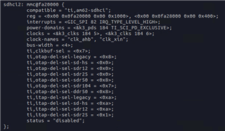

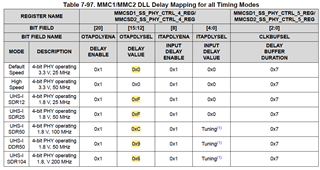

My customer reported eMMC DLL delay values used in Linux SDK do not match to datasheet values.
Which ones are correct?
Datasheet values:

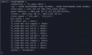

Device tree "./arch/arm64/boot/dts/ti/k3-am62-main.dtsi"
Even in device tree, there are differences between mmcsd1 and mmcsd2.
