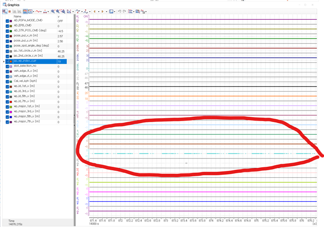

TDA4VM: MCU2_1 CAN sgianl lost
Part Number: TDA4VM
I'm testing CAN TX and RX on MCU2_1 while running our own vision app. However whenever I try to send CAN signal, signal loss happens after few minuites later.
To use CAN TX/RX on MCU2_1, fixed dts file and disabled mcan2 and enabled STB pin to active high. After then I confirmed TX/RX test between A72 main_mcan0 and MCU2_1 main_mcan2 after booting without running the vision app.
I'm not using TIVX or OpenVX but implemented native FreeRTOS task in main.c file. Each TX and RX has their own task to run and TX task runs every 10ms using vTaskDelayUntil.
At the begining, I tried to use 32 TX buffers by setting txBufNum of MCAN_MsgRAMConfigParams. But I changed it to use only one TX buffer after going over mcan examples.
Is there any blind spots that I couldn't recognize?
  • CAN Baudrate : 500kb/s
  • CAN Datarate  : 1Mb/s
  • Max. CAN Bus load : < 50%
Here is the CAN config code

And this is the TX function which is called every 10msec and main function I modified.
The 'avpMain' is the function that has the 'mcan_tx'  function.
