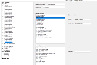

  • Hi Roopa,
    have you set the MAC address in the Conformance tool correctly?
    Under
    SCT Editor->Physical Data->TCP Interface 1
    and also
    SCT Editor->Ethernet Link->Instance Group 1->(in Attribute Description) Physical Address
    After the changes, save the .soc file and then try again.
    Pourya
  • Hi Pourya Eskandari,
    I have set the MAC address in both Physical data and Ethernet link then i have try to run the conformance test(connection manager specific test ) but then also we are getting same logs and also we are getting another error in the UART logs is "tcp_err_handler: Connection aborted. (-13)".
    How to fix this issues please give me suggestions.

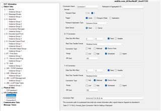

  • Hi Roopa,
    looking again at your logs, it seems that I/O configuration is wrong. Please make sure that for connection1 the Transfer format is set to "Modeless Format".
    The "tcp_err_handler: Connection aborted. (-13)" is related to TCP/IP section. you can safely ignore it in this case.
