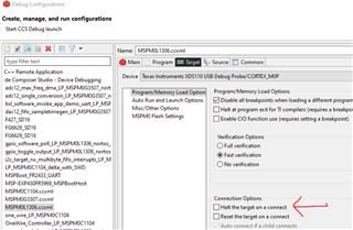

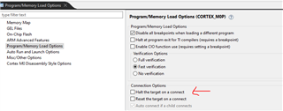

It seems when I disable the halt the target on a connect as below(three points that related with the project)
But when I click the connect target after launch the ccxml file
It always halt the target as below
Can we support not halt the target when connect the it?
    Please note the device needs to support non-intrusive connect. Usually the device needs to support real-time debug. Based on your screenshots, it looks like you are using MSPM0. This device does not support real-time debug.
