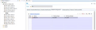

Is it possible to have only one MCAL configuration for FLS driver for both XSPI flash device (s28hs512t) and QSPI flash device (mt25qu512abb) ?
I ask this, because in the provided SDK are individual configurations for each flash device, and in MCUSW documentation page (https://software-dl.ti.com/jacinto7/esd/processor-sdk-rtos-jacinto7/latest/exports/docs/mcusw/mcal_drv/docs/drv_docs/ug_fls_top.html) is written: "Currently only one flash device can be used at a time on J721S2"
I tried to add another FlsMemConfiguration in the provided EB Tresos configuration of FLS Driver, unfortunately I cannot add another one (see picture below).
If it is possible, how can I get an update of the Fls.xdm file?
Thank you!
