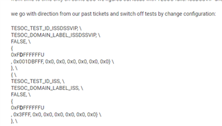

from time to time only on some ECU we figured out issue with TESOC fails: ISSDSSVIP and ISS.
we go with direction from our past tickets and switch off tests by change configuration:
TESOC_TEST_ID_ISSDSSVIP, \
TESOC_DOMAIN_LABEL_ISSDSSVIP, \
FALSE, \
0xFDFFFFFFU
, 0x001DBFFF, 0x0, 0x0, 0x0, 0x0, 0x0, 0x0} \
TESOC_TEST_ID_ISS, \
TESOC_DOMAIN_LABEL_ISS, \
FALSE, \
0xFDFFFFFFU
, 0x3FFF, 0x0, 0x0, 0x0, 0x0, 0x0, 0x0} \

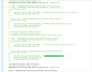

issue is not resolved. When we manually commented out taking result from this 2 domain.
It is working as expected and issue cannot be reproduce -> looks like it solved issue.

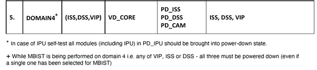

    1.   The ISS and DSS and VIP are part of the CORE domain, and as such all need to be disabled before TESOC can test any one of them.  It should be possible to modify the test sequence to only test VIP without testing DSS and ISS.
    2. If you're not using ISS and DSS then you should not run TESOC on those IP.  They are physically there in the die, but should not be used on part number variants that don't support ISS and dSS.

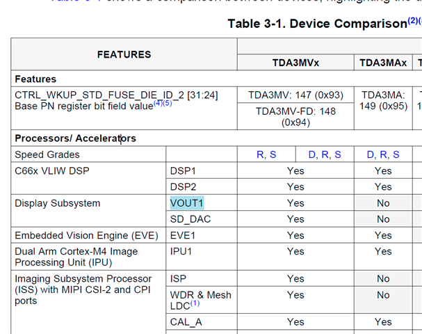

  • Hello, I do not have access to the link above and we have that PDF. we have additional question to your point:
    1. Can you propose how we should modify the test procedure to limit the test to VIP only?
    2. Does that mean that chips with our part number do not support ISS and DSS?
    3. We observe the problem with TESOC during ON/OFF tests. Not all chips are affected. We did not measure the statistics.
    1. We are investigating internally.
    2. That is correct.  Referring to the data manual:
    You can see that Display Subsystem and ISS/ISP are "No" (i.e., not supported).
    3. Is it possible for you to collect statistics?  How many units fail vs pass?  And for units that fail ... how often do the tests fail?  How do you control the ON/OFF cycling?  Are you ensuring that the power supplies are completely off (0V) before powering up again?

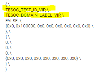

  • Hello Krysztof,
    Can you try replacing the highlighted code with this:
    TESOC_TEST_ID_VIP, \
    TESOC_DOMAIN_LABEL_VIP, \
    FALSE, \
    {0x0, 0x1C0000, 0x0, 0x0, 0x0, 0x0, 0x0, 0x0} \
    0, \
    0, \
    0, \
    {0x0, 0x0, 0x0, 0x0, 0x0, 0x0, 0x0, 0x0} \
    This should run tests on VIP only (not DSS and ISS).
    Kyle

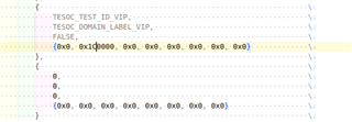

    what you mean highlighted code?
    is it?
    here we can see different domain then what you provided
    we should keep your previous suggestion or ... ?
    Krzysztof
    we did changes
    it does not solved our issue,
    Krzysztof
