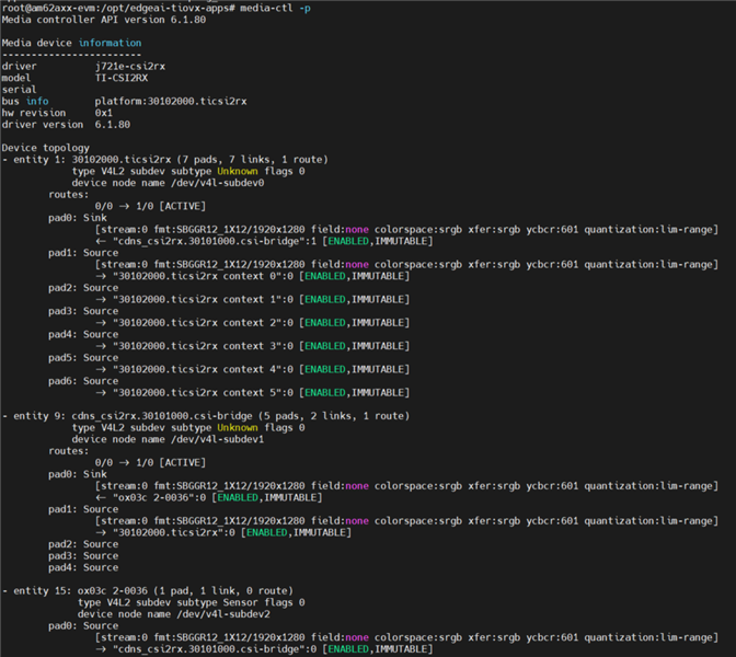

Somehow when running the following script, the output didn't show any error while there is no output in the screen:
The yaml in use is as follows:

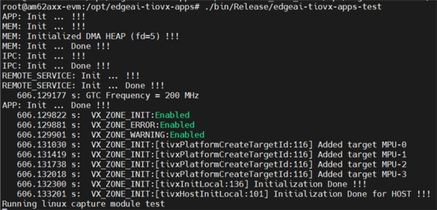

and the app printed these:
I've also tried the image input, whether outputing in the screen or generating files, it works just fine.

I think the major problem is from the sensor related configurations, as the above configuration can utilize the LINUX_DISPLAY correctly. So I compared related configurations in both gsttiovxisp.c and edgeai-tiovx-apps. The problem here is that there are so many different struct definitions, making it hard to pin-point the differences in the initialization and configuration process. Would you please give me some hint about what to pay attention to?
BTW, the gstreamer pipeline works fine so there shouldn't be anything wrong with the sensor.

  • Hi Jingjie,
    I recommend you to try the new sensor with the simple capture display test
    edgeai-tiovx-apps/tests/app_tiovx_linux_capture_display_test.c at develop · TexasInstruments/edgeai-tiovx-apps (github.com)
    This is much simpler code and easier to debug
    https://github.com/TexasInstruments/edgeai-tiovx-apps/blob/6abbb460ef29b7aba650e29c1703d9edaba174aa/tests/main.c#L84
    You can enable the test by making above line as 1

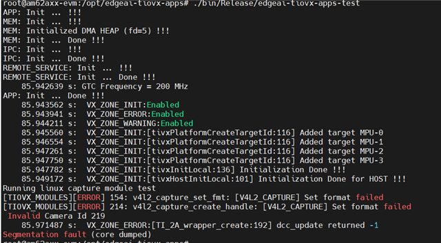

  • Hi Rahul,
    Thank you very much for the reply.
    I tried the test you mentioned, but the result is very weird:
    I've add the sensor_name to dccId related code in tiovx_sensor_module.c for previous trial, and this time changed the sensor name in app_tiovx_linux_capture_display.c, but the program still assigned the dccId for imx219.
    Here is the modified code of app_tiovx_linux_capture_display.c:

    #define INPUT_WIDTH  (1920)
    #define INPUT_HEIGHT (1280)
    #define SENSOR_NAME "SENSOR_OX3C"
    #define DCC_VISS "/opt/imaging/ox03c/linear/dcc_viss.bin"

        v4l2_capture_init_cfg(&v4l2_capture_cfg);
        v4l2_capture_cfg.width = INPUT_WIDTH;
        v4l2_capture_cfg.height = INPUT_HEIGHT;
        v4l2_capture_cfg.pix_format = V4L2_PIX_FMT_SBGGR12;
        v4l2_capture_cfg.bufq_depth = APP_BUFQ_DEPTH;
        sprintf(v4l2_capture_cfg.device, "/dev/video3");
        v4l2_capture_handle = v4l2_capture_create_handle(&v4l2_capture_cfg);

    Also seems like v4l2_set_fmt is failing, Please review if you are setting correct format that you are using in media-ctl command
    Rahul T R
  • Hi Rahul,
    I added the code and got rid of the dccId problem, still there is no output.
    The test program printed these:
    As for the format issue, the media-ctl says:
    I suppose the format should be V4L2_PIX_FMT_SBGGR12 in our case, and the test program didn't argue this time. Don't know why it has the fmt error previously.
    Huang Jingjie
  • Hi Rahul,
    I added print in both enqueue and dequeue sequence. According to the log only two frames are enqueued, and it took a significant amount of time before these print show up.
    I'm not sure how this happened, while the camera can output video stream normally via gstreamer or v4l2-ctl.
    Huang Jingjie
