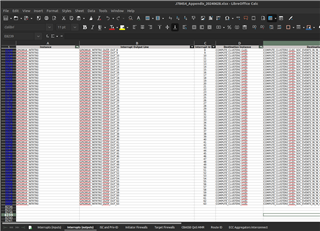

I have an issue with getting interrupts on C7x processors for J784S4 EVM (PROC141E4). I have configured the MAIN domain GPIO_11 as input which is connected to SW3 on the board. The PADCONFIG_11 register is set to 0x00240007 as referenced from the register map excel file. (j784s4_public_combined_july2023.xlsx) My SDK version is 9.1.0.6. I don' t have any issue when running the same program on MAIN domain MCUs. (R5F) and GPIO callback function is successfully executed when I push the SW3 button. However, in case of C7x,

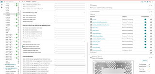

In GPIO_socConfigIntrPath function located in <ti/drv/gpio/soc/j784s4/GPIO_soc.c>
retVal = GPIO_socGetIrqRange(ir_id, dst_id, &irq_range_start, &irq_range_num);
returns -1. When I debug it, I observe that,
        retVal = Sciclient_rmGetResourceRange(
                &req,
                &res,
                SCICLIENT_SERVICE_WAIT_FOREVER);
returns CSL_PASS at line 707 in the same file GPIO_soc.c. However, res.range_num is 0 and GPIO_socGetIrqRange returns with CSL_EFAIL
I guess Sciclient sends request to sciserver which is a part of SYSFW running on WKUP domain MCU and then gets the response from it.
So, what is the reason of getting number of range 0 from sciserver? Am I missing something to configure for C7x case since it works on R5F?
