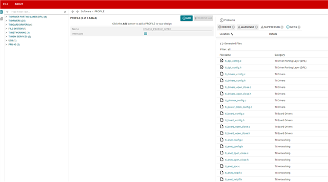

  • I checked out the RESOURCE_ALLOCATION in the API docs that you posted. In the example, it shows that you can do it with the sysconfig tool. However, the example seems to be displaying options in the sysconfig tool that I don't have in mine. Here's what mine looks like
    As you can see on the left hand side tab, the options that I have do not include the SYSFW RESOURCE PARTITION option like in the example you supplied.
  • Hello Eden,
    Thank you for your response.
    The above screenshot is showing the basic Pinmux features of sysconfig tool coming from MCU+SDK.
    Have you tried running the below command from root directory of MCU+SDK?
    gmake -s -C tools/sysfw/boardcfg configure SOC=am64x
    Please follow the steps suggested here to change the default resource allocation.
    Please let us know if you face any difficulty.

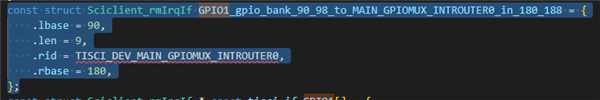

  • Ok that seemed to work for both my interrupts. Thanks!
    However, I have a couple questions.
    When you set
    rmIrqReq.src_index = TISCI_BANK_SRC_IDX_BASE_GPIO1 + GPIO_GET_BANK_INDEX(7)
    that value is 90 (90 + 0) where the offset is 90 and the bank index is 0 because GPIO1_7 is in bank 0. But when you look at all the source interrupt Ids in the cslr_intr_main_gpiomux_interouter0.h header file, the value 90U is assigned to, if I understand correctly, GPIO1_0 pin interrupt (not bank interrupt). You can see this with the following image
    If I'm setting it through a bank interrupt (in the case of GPIO1_7 it would be GPIO1_BANK0), shouldn't the value be 180U like so
    Also, how did you know that I should use
    CSLR_RF5SS0_COR0_INTR_MAIN_GPIOMUX_INTEROUTER_OUTP_7
    and
    CSLR_RF5SS0_COR0_INTR_MAIN_GPIOMUX_INTEROUTER_OUTP_6
    respecitvely? From my resource allocation file I can sort of deduce that for r5f0_core0 I can use the outputs 0 to 8 as there are 8 resources available at index 0.
    Thanks!
  • Hello Eden,
    Thanks for your confirmation.
    This values are automatically propagated according to the rmIrqReq.src_id passed in the Sciclient_gpioIrqSet fucntion. This values are referenced from the sciclient_irq_rm.c file located at ${MCU+SDK}\source\drivers\sciclient\soc\am64x_am243x path.
    Please refer to below screenshots
    and
    respecitvely?
    Please refer to the sciclient_defaultBoardcfg_rm.c file located at ${MCU+SDK}\source\drivers\sciclient\sciclient_default_boardcfg\am64x directory to see all the resource allocation. The GPIOMUX Router number 0 to 7 are allocated/shared between R5FSS & A53SS core.
    Please refer below screenshot.
    Hope the above information helps.
    Tushar
