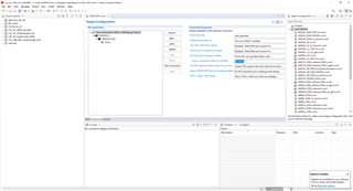

Hello everyone, I've been encountering some issues with the C5502 DSP board. Although I've managed to temporarily resolve them, they reappear after some time. I wonder if there’s a permanent solution to these problems.
  1. Error connecting to the target:
    • Error -1063: Device ID is not recognized and is not supported by the driver. Confirm that the device and debug probe configurations are correct, or update the device driver (Emulation package 9.12.0.00150).
    • Solution:
      1. Remove the power supply from the DSP board.
      2. Replug the USB cable connected to the debug probe.
      3. Reconnect the DSP power supply.
  2. Error initializing emulator / error connecting to the target:
    • Error -2083 / Error -2172: Unable to communicate with the debug probe. Confirm debug probe configuration and connections, reset the debug probe, and retry the operation (Emulation package 9.12.0.00150).
    • Solution:
      1. Remove the DSP power supply.
      2. After waiting more than 10 seconds, reconnect the power.
Additionally, here is the test connection result log:

Thank you in advance for any advice or insights from the experts and seniors here!
