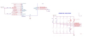

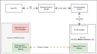

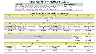

We are in the process of bringing up our custom hardware. Our design requires dual EMAC support, with one being copper-based and the other fiber-based via an SFP port. We have configured eth0 as the fiber port and eth1 as the copper port, utilizing ICSSG1 Ethernet interfaces. The PHYs used are DP83869, with the design adapted from TMDS64EVM. We have modified the device tree file accordingly (details below - only ethenet specific part). The PSDK version used for testing is '09_00_00_03'. While we successfully brought up the copper port, the OFC port is not functioning. Additionally, we encounter an exception shortly after the Linux (RT) load. The log is attached below. When we modified the device tree to use the copper (DP83869_RGMII_COPPER_ETHERNET) instead of the OFC (DP83869_RGMII_1000_BASE/DP83869_RGMII_100_BASE) option, the crash disappeared. What could be causing this issue? Is there anything specific we need to do for the OFC port?
We also tried using PSDK version 09.02.01.09, but we experienced the same issue.
We used an SFP media converter to establish SFP pair connections to the custom board.
Kindly help.

  • Hi Chris,
    When the port is set as DP83869_RGMII_COPPER_ETHERNET and the crash disappears, are you able to communicate via the fiber port?
    For DP83869_RGMII_100_BASE or DP83869_RGMII_1000_BASE set in dts, please share the register dump for DP83869 so I can confirm the PHY's config is set correctly. As Nick mentioned, it's possible the link speed is not set correctly on either MAC or PHY side, causing link to fail for fiber.
    Thank you,
    Evan

  • Dear Evan,
    No. We are using an SFP port and it is expecting only a fiber module as per the design. So we can only check with a fiber module right now .
    Sure, I'll share the dump as soon as possible. Please bear with me for the delay as I am traveling.
    I had attached the strap details in the first post, which is configured for fiber. Previously, when I measured the PHY register values, they showed the default (1G copper mode) despite the strap being set for fiber. Could this be causing an exception? We have raised another query related to this. - thread
    Thank you
    Chris
  • Hello Chris,
    It's hard to tell from my side whether the issue is related to something in the HW strapping / kernel configs, or related to the fact that it is connected to PRU Ethernet rather than CPSW. Let's keep debugging things from the PHY side for now, and while yall are doing that I'll ask around with a couple more team members.
    Nick
  • Hi Chris,
    Incorrect register values could be a function of unintended strap behavior, but is more likely function of errors in the register read/write process for extended registers.
    Please confirm this procedure is being used to read/write registers beyond address 0x1F:
    write address 0xD = 0x1F
    write address 0xE = 0x6E
    write address 0xD = 0x401F
    read address 0xD (returns the value in 0x6E)
    Sharing 0x6E will help me confirm the intended straps are being set properly.
    Thank you,
    Evan

    In addition to the register read-out mentioned above, can you please confirm the DP83869 driver version is being used?
    Here is out latest driver for 869, there are some fixes to configure_fiber function when using DP83869_RGMII_1000_BASE / DP83869_RGMII_100_BASE options:
    https://github.com/TexasInstruments/ti-ethernet-software/blob/main/linux_drivers/dp83869.c
    Is this the same driver being used in your system?
    Thank you,
    Evan
  • Thanks Nick. I will check the strapping details with hardware team and go from there
    Thank you
    Chris

    The BMCR register value initially displayed as 0x1140 (default). I attempted to disable auto-negotiation by setting the value to 0x140 using the phytool command ( phytool write eth0/15/0 0x140). This change successfully brought up the OFC interface with a valid IP address, although I still encountered an exception during boot. I tested this with the existing PHY driver from PSDK release 09.02.01.09, and it worked. However, after updating the PHY driver to the latest version from the git source, this method no longer works—setting the PHY register value to 0x140 is ineffective.
    I am also attaching the OFC section schematic also as a reference purpose
    A3_OFC.pdf
