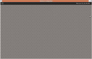

    If you booted up the board and see this screen, you are seeing the weston compositor is up and running and ready to run wayland applications. Now, we need to run a wayland app. A simple one to run is glmark2-es-wayland.
    Any openGL ES application drawing something simple using EGL/Wayland is all I need.

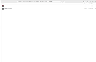

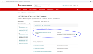

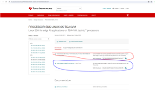

  • We might have miscommunication about what you mean when you say the x86 Linux installer.
    By the  x86 installer, I mean the software package meant for PC installation rounded in blue. The one in red is the SD card image running on the TDA4.
  • As you can see, both are available for the version 8.6 (1th March 2023).
    However, I can only see the SD card image for the version 8.5 as shown below:
    So this has me a bit confused.
    Does the x86 SDK link provided by you match the SD card image (8.6)?There seem to be 2 pages, one providing SD card images along with the x86 SDK installer. And another page just providing the installer. Or have I got it completely wrong?
    regards,
    Ali
  • Ali,
    I think I understand the situation now. So there are two boards for TDA4VM that TI provides, the EVM and the SK-board. I believe you are using the SK board then. Before SDK 8.6, we provided only the SD card image because they SoC is the same, it just uses a different device tree file, and different boot binaries.
    So, for SDK 8.5, you can download the Linux SDK from this link and it will also work, but it will require that you use different device trees and boot binaries because they are HS-FS devices. Unfortunately these details are lost in the history, but now I think we are on the same page.
    So, if you want to boot the SDK 8.5 on the SK board, you can use the SD card. You can get the components from the Linux SDK from the link above.
    Let me know if that's clear, and now we can see what you need to run the test.

  • Hi Erik,
    Sorry for the late reply.
    I had installed the wrong SDK(meant for the SK board). I have now corrected it to the SDK meant for the EVM board.
    I am actually using the EVM common board with a TDAVM(J721EXSOMG01EVM). I have now installed the SDK from the link you provided. I am copying that link here for reference:
    https://www.ti.com/tool/download/PROCESSOR-SDK-LINUX-J721E/08.05.00.08
    I have created the SD card from the mksdboot.sh script in the "ti-processor-sdk-linux-j7-evm-08_05_00_08/bin" directory.
    Now I am trying to compile the same example as before (https://gist.github.com/propella/949261f89d83a6e184fb745a48de27c3 with version 8.5.

    The problem that I have noted is that the header file and library paths (marked in red below) specified by the documentation (https://software-dl.ti.com/jacinto7/esd/processor-sdk-linux-jacinto7/08_05_00_08/exports/docs/linux/Overview/GCC_ToolChain.html) do not exist in the SDK installation on my PC:
    This is how the  "linux-devkit/sysroots" folder on my PC's SDK looks like:
    Therefore , I am pointing the gcc sysroot option to the "{SDK_INSTALL_DIR}/targetNFS" folder with an additional "-L${SDK_INSTALL_DIR}/linux-devkit/sysroots/aarch64-linux/usr/lib " option.
    I have the following questions now:
    1. How can I fix the missing folder issue (if it is an issue at all)
    2. How can I fix the linker errors? (my understanding is that it is linked to the issue above)
    3. You can also suggest any other example that draws something on the screen. I chose this example as you have already tried it with the 8.5 version, which I am now using.
    regards,
    Ali
  • Ali,
     aarch64-none-linux-gnu/bin/ld: /tmp/ccLFgQIs.o: in function `pointer_handle_enter': simple-egl.c:(.text+0x12d8): undefined reference to `wl_cursor_image_get_buffer'
    Looks like it's missing a definition for this wayland function. One of the libraries in the sysroot should provide this function definition, perhaps libwayland, but need to find where that is located.
    Looks like the sysroots are somewhat built, but yes, it seems to be missing your <device-specific> folder in your sysroot. You can fix this by building Yocto on your own again. This is a tedious process with older SDK releases because there are small changes in the upstream projects used that can require small tweaks in the Yocto configurations/recipes to get it to build. But when you build Yocto and build the sysroots, you will get a folder specific to your machine (j7-evm, j721se-evm, etc.)
    Just need to install the library that has this function definition. Problem is identifying the library that has this definition and installing it into your sysroot. It's simple if you have a Yocto setup, it can be tedious without one.
