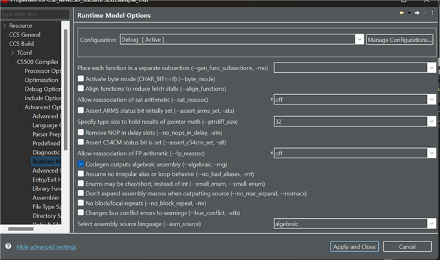

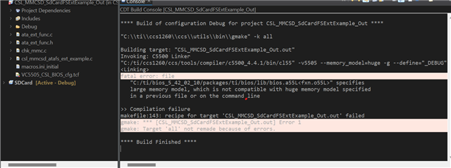

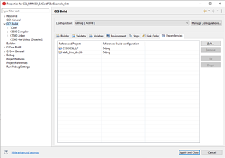

  • Hi Ming,
    As your refernce i take this example : C:\ti\c55_lp\c55_csl_3.08.01\ccs_v6.x_examples\mmc_sd\CSL_MMCSD_SdCardFSExtExample.
    Import project and install latest DSP BIOS version dsp bios_5_42_02_10
    Now i got an error
    Previous discussion as my knowledge  change properties to normal to huge and runtime model 32 ptrdiff
    After i run these application i got some another error
    Can you help me please

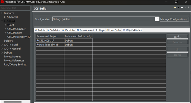

  • Hi Kishor,
    This project has two dependent projects: CSL and ATA file system. My guess is that you have changed the CSL library project to huge model before. Please change all three projects back to large model. It should fix your build issue.
    Ming
  • Hi Ming,
    By default is already there two project dependencies
    Now i got clear errors my mistake is dependencies project has huge model and MMCSD project has large model these both has didn't matched after change clear my errors
    Thanks Ming

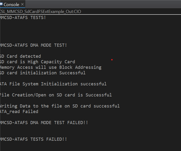

  • Hi Ming,
    1. c55_csl_3.08.01\ccs_v6.x_examples\mmc_sd\CSL_MMCSD_SdCardFSExtExample (to read the audio data from the wav file from SD card)
    Analyze read function
    for(index = 0; index < CSL_MMCSD_ATA_BUF_SIZE; index++)
    gMmcWriteBuf[index] = 0x4142;
    AtaWrBuf[index] = 0x4344;
    gMmcReadBuf[index]=0x0;
    ata_error = ATA_readLittleEndian(pAtaFile,gMmcReadBuf, CSL_MMCSD_ATA_BUF_SIZE);
    if(ata_error != ATA_ERROR_NONE)
    printf("ATA_readLittleEndian Failed\n");
    return(ata_error);
    else
    printf("\nReading Data from the file on SD card successful\n");
    printf("txt", gMmcReadBuf[index]);
    printf("Read Data: %s\n", gMmcReadBuf);
    Could not find wav file library and any other Apis
    can you tell me what is the process of how to read  wav file from sd card in tms320c5535 board.provide  wav file libraries
  • Hi  Kishor,
    There is no WAV file read API in the CSL. There ATA file system API only has file open/close, read/write and seek functions. For WAV file format, please refer to the following document: WAV - Waveform Audio File Format. You have to write your own WAV file reafunctions.
    Ming

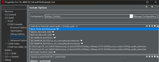

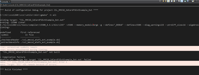

  • Hi Ming,
    I have research about WAV file found an wav header files in CSL "C:\ti\c55_lp\c55_csl_3.08.01\demos\out_of_box\c5545\c5545bp_software_01.01.00.00\source_code\c5545bp_audio_demo\inc\wave_parser.h"
    So develop code with ATA File system with Wave_parser.h file

        ata_error = ATA_fopen(pAtaFile, fileName,"rb");
    #endif
        	printf("ATA_fopen Failed\n");
            return(ata_error);
        else
    		printf("\nFile Creation/Open on SD card is Successful\n");
    	/* Write data to the file */
    //    ata_error = ATA_write(pAtaFile, gMmcWriteBuf, CSL_MMCSD_ATA_BUF_SIZE);
    //    if(ata_error != ATA_ERROR_NONE)
    //		printf("ATA_write Failed\n");
    //        return(ata_error);
    //    else
    //		printf("\nWriting Data to the file on SD card successful\n");
    	/* Reset the file pointer to the beginning */
    	//ATA_seek (pAtaFile, 0);
    	/* Read the data from the file in little endian mode */
        ata_error =ATA_read(pAtaFile,gMmcReadBuf, CSL_MMCSD_ATA_BUF_SIZE);
    		printf("ATA_read Failed\n");
            return(ata_error);
        else

    Now Compile it appears wavefile related errors
  • Hi Kishor,
    You will need to include the c55_csl_3.08.01\demos\out_of_box\c5545\c5545bp_software_01.01.00.00\source_code\c5545bp_audio_demo\src\wave_parser.c in your project. This file has the definition of the extractWaveInfo and checkWaveHeader.
    Ming
  • Hi Ming,
    previously i'm done at include path options but it appears same error log
  • Hi Kishor,
    The "include search path" is for the compiler to search for the wave_parser.h. It has nothing to do with where to find the source file. You have to add the wave_parser.c file into your CCS project.
    Ming
  • Hi Ming,
    Define wave_parser.c in my main file
    It show error object inside file wave_parser.c
  • Hi Kishor,
    Add the following function into your CCS project:
    /* Swap bytes in a given buffer */
    void swapBytes(Uint16 *input, Uint32 length) (defined in c55_csl_3.08.01\demos\out_of_box\c5545\c5545bp_software_01.01.00.00\source_code\c5545bp_audio_demo\src\audio_data_read.c)
       Uint32 index;
       Uint16 byte;
       for (index = 0; index < length; index++)
          byte = (input[index] & 0xFF) << 8;
          input[index] = (input[index] & 0xFF00) >> 8;
          input[index] |= byte;
    #define SWAP_WORDS(x) (x = (x >> 16) | (x << 16)) (defined in wave_parser.h)
    Ming
  • Hi Ming,
    After declare swapbytes inwave_parser.c it clear errors and sucessfuly run
    but in my consloe ATA Read operation is failed,my dought is its properly intialized or not atafopen function for wav file and write and read also.
  • Hi Kishor,
    Without the source code, I cannot tell where the problem is. From the display, it looks like the file open and write are done. Th error is at the file read.
    You can use single step debugging to trace down where the problem is.
    I will close this thread for now, since the original question is resolved. You can raise another e2e thread if you have different issue.
    Ming
