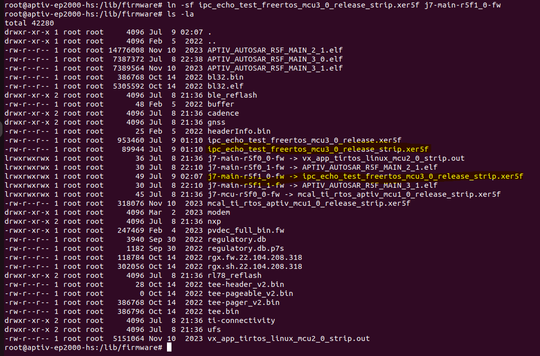

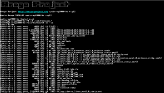

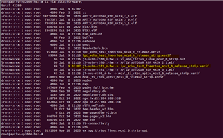

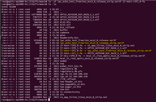

  • I'm using FreeRtos example: freertos_test_task_switch_mcu3_0_release_strip.xer5f generated when I use this target:  make -s freertos_test_task_switch BOARD=j721e_evm CORE=mcu3_0. The original application with PSDK7 is a customized application used to process CAN data. The example I'm trying to run is freeRtos only.
    I generated the example you mentioned (IPC) using this command: make -s ipc_echo_test_freertos  BOARD=j721e_evm CORE=mcu3_0
    I replaced the symlink to point to the new binary. This time there is no reset but I still see the old image being executed.
    Attached are the images and the Linux logs.
     1805.Linux_Log.txt
    Regarding boot flow, we are using tispl which has mcu0 and u-boot to load other binaries.
    Jose Daniel
    The soft link command, might need full file path like below.
    # ln-sf  /lib/firmware/ipc_echo_test_freertos_mcu3_0_release_strip.xer5f j7-main-r5f1_0-fw
    Can you please check with above command once. If not working please provide full path for "j7-main-r5f1_0-fw" also as below and check once.
    /lib/firmware/j7-main-r5f1_0-fw
    Sudheer

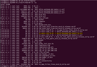

  • I tried but I got the same result. Please note that I'm doing all these changes in primary partition (sda1).
    José Daniel
    You suppose to do it in /media/<user>/rootfs when sd card inserted in pc.
    Or you can do once after booting of board.
    Sudheer
  • I dont get it, I'm not using SD card, I'm using UFS.
    José Ambrocio
    Can you confirm, are you doing soft link after booting Board.
    Is the softlink is still same after power cycle of Board? If not you are not making change in file system.
    Once after A72 Linux bootup you can change soft link but, it will not affect immediately as boot is already completed.
    You have to use this command for softlink from root.
    After above command use #sync
    Also, refer to below Link.
    https://software-dl.ti.com/jacinto7/esd/processor-sdk-linux-jacinto7/latest/exports/docs/linux/Foundational_Components_IPC_J721E.html#booting-remote-cores-from-linux-console-user-space
    If you want to force perform fimrware loading, you can using remoteproc commands once after Linux boots up.
    using #remoteproc <ID> start/stop command refer to above link.

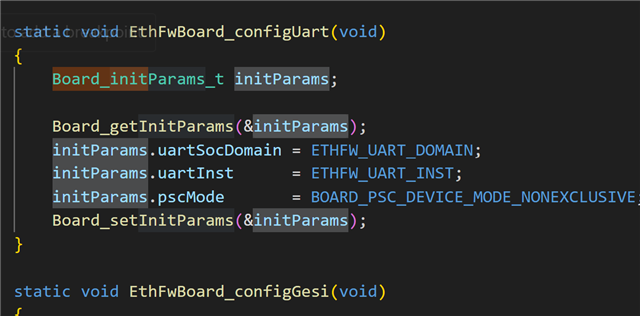

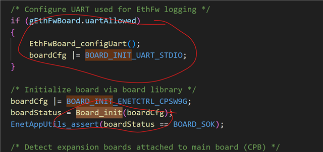

  • HI,
    boardCfg = BOARD_INIT_PINMUX_CONFIG  | BOARD_INIT_UART_STDIO;
    status = Board_init(boardCfg);
    Board support will configures the default UART0 Instance as per Domain (Main /MCU) the core is running.
    As your are using MCU3_0 core, it will configures Main UART0 which is using for A72.
    In my original device using sdk7, one UART port was being used to send logs from MCU2_1, MCU3_0 and MCU3_1 cores. One dedicated UART port for Linux logs and also one dedicated UART for MCU1_0. I want to have the same for new psdk9.
    You have to modify global UART configuration in MCU3_0 application in order to use other UART instance.
    Please make similar change in SDK9, what you have followed in SDK7.
    Please refer to MCU2_0 Ethfw uses Main UART2 for debug logs. Similar changes you have to make in MCU3_0.
    Above is called before invoking Board_init(boardCfg);
