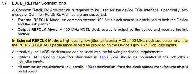

Hi Support Team,
Am I correct in understanding that LP-HCSL is applicable to AM5746
as described below in Datasheet: 7.7 LJCB_REFN/P Connections?

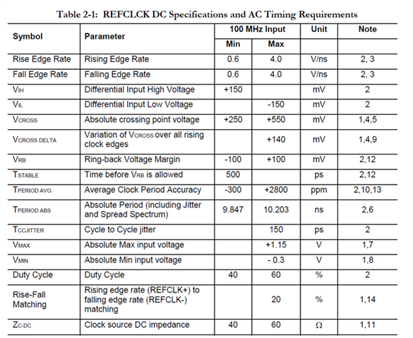

The following is described in 2.1.3. REFCLK AC Specifications of the PCIe REFCLK AC specification
(Exhibit: PCI ExpressTm Card Electromechanical Specification Revision 1.1).
Is it OK if this specification is fully applied?
