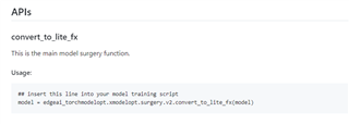

    4. We noticed that to overcome issues related to the unsupported layers of YOLOv8m, we have to perform a "surgery" on the model in the model optimizer. We are proceeding now with this step to adapt our model for the benchmark. Our expectation is that this would give us model for the edgeai_benchmark, which would then be able to generate the necessary files for the model deployment on board. Correct?
            5. For the surgery we are using default function for replacement.
            6. Considering that the surgery functions also perform model training with 100 epochs, which requires a considerable amount of time, we would like to know what are the ways we could shorten or omit that training              process, in order to first perform model verification, and will train properly afterwards?

  • There is some bug in model-surgery_v2, we are looking to fix it. Can you try using model-surgery_v1, passing the argument as " --model-surgery 1 ". This should work fine.

  • That was the problem, now i managed to run the training script, thanks a lot. Is it possible to set the number of epochs as a command line argument because I couldn't find a place in the code where I could explicitly set the number? By default it takes a very long time, I would like to reduce the training duration.
  • You can set max_epochs = {some number} , in the config file

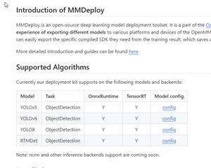

    I get a .pth model. Also, within the mmyolo repository I saw that mmdeploy (github) is used to convert models (in my case from .pth to .onnx), but this part bothers me:
    I need to convert yolov8, especially yolov8m. Does this mean there is no way to convert for yolov8?
    Also, I'm interested in which pipeline was used to get yolov8s lite, whose zip is available in the discussion at the following link (I managed to put it in the input of the edgeai-benchmark and run it on the board with all the built artifacts)? I hope you can help me how to do same with yolov8m. Thanks in advance.
  • If you are using the patch update of mmyolo as mentioned by Manu, it supports onnx export within mmyolo itself and mmdeploy is not required.
    In order to export the model to .onnx format you can use the following script - projects/easydeploy/tools/export_onnx.py
