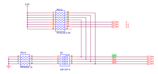

3. BOOT mode set to (16bit  Async memory (on CE1 space) or Execute from 16bit  Async memory (on CE1 space) both didnt work.

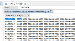

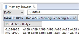

Due to Verification failed: Values at address 0x403746@DATA do not match Please verify target memory and memory map issue,  I tried simple code below write 0xABAB to 0x403746 but it fills the data into the entire memory.

testData = 0xABAB;
SdramBASEp = (Uint32*)0x400000;
*(SdramBASEp) = (Uint32)testData;
Please advise me why Values at address 0x403746@DATA do not match Please verify target memory and memory map issue and why when I wrote value to 0x403746 it fills entire memory with the same value ( i.e. 0xABAB). Also define 0x400000 memory space as program memory instead of data memory?. The 5509A gel file configured as below:-
