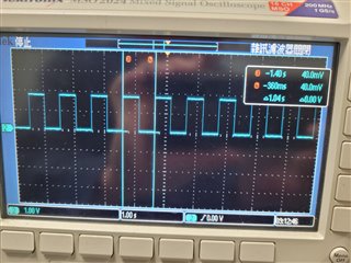

    oscilloscope on the pin.
    led_blink.tar.gz
    The interrupt is getting triggered as INTSTAT23 is updated every time but the callback function is still not getting called.
