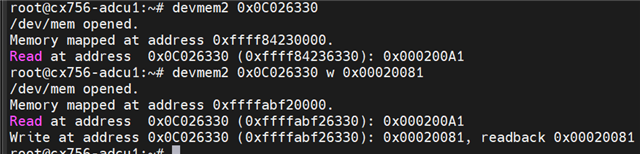

Furthermore, since the link up/down status of mac_port5&phy will affect the network performance when the MIrroring is turn on, I have examined which registers will be changed by phy link down. Finally I found that the GMII_EN (bit5) of the register CPSW_PN_MAC_CONTROL_REG_k played a decisive role.
In the above Mirroring enabled situation, if the collecting device is link up, the register CPSW_PN_MAC_CONTROL_REG_k will  be set to 0x000200A1 by driver, then if i write it to 0x00020081 manually , the fault will occur.
On the contrary, even if the collecting device is link down. As long as I configure the register to  GMII_EN Enable, the network will be restored.
So maybe you can explain this phenomenon.
Since GMII_EN is control by driver, it reflects the connection status of GMII, we'd better not proactively modify it.  But in the case of GMII disabled, Mirroring  will cause malfunctions, so should we have to open/close MIrroring when macport5 got_link or lost_link?

    GMII_EN is to enable Gigabit MII interface, it should be set for all Gigabit interface mode.
    If you make GMII_EN as 0, then Tx & Rx will not happen.

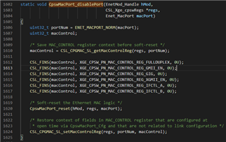

    but this is cpsw.c of pdk0900. We can see that GMII_EN will be set 0 when PHY lose link...
    if our MIrroring is still on  this time....TDA4 will not be able to communicate with the outside world.
    if the quality of the network depends on an unstable PHY connector. Isn't this a bit too dangerous?
    i mean. just the phy link for macport5 (mirror toport) has gone down, but all other cpsw macports are unable to send messages externally,
    It's a bit too excessive......

    GMII_EN is per port specific, Whichever the Port is Link down only that particular port will be disabled.
