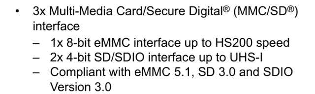

2. eMMC: we wants to know the data speed for the eMMC0, and plesae provide your commend if we can use the less storage capacity eMMC instand of MTFC32GAZAQHD-IT(32GB), we need to reduced cost for our project;
