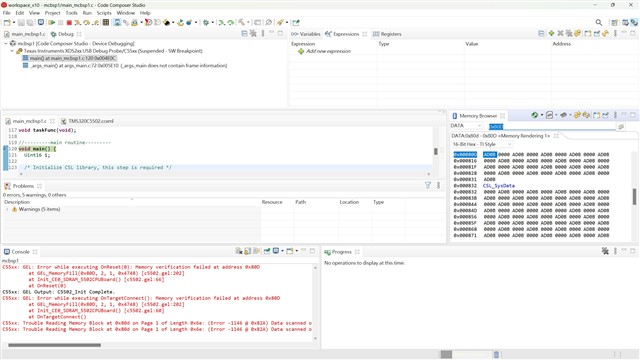

When I try to execute the main.c code, CCS continuously shows 'Trouble Reading Memory' and jumps to the location in SYS_INI.asm where PLL initialization is attempted, but none of the contents in SYS_INI.asm are executed.
I have tried checking the GEL file, the VC5502.cmd file, and performing a test connection, but I can't identify any issues.
Therefore, I would like to ask for advice from all the experts:
What other approaches can I take to debug this issue?
If there are other files or details you need me to provide, please let me know!
This problem has been troubling me for weeks, and I'm very grateful for your help!
Console log:
C55xx: GEL Output: OnReset.
C55xx: GEL Output: C5502_Init Complete.
C55xx: Trouble Reading Memory Block at 0x4ed1 on Page 1 of Length 0x1: (Error -1143 @ 0x4ED0) Device core was hung. The debugger has forced the device to a ready state and recovered debug control, but your application's state is now corrupt. You should have limited access to memory and registers, but you may need to reset the device to debug further. (Emulation package 9.12.0.00150)

  • Hi Jun-ting,
    What C5502 board are you using (custom board or C5502 EVM)? What CCS target configuration were you using (C5502 or C5502 EVM)? What GEL file are you using? What is your boot mode?
    Ming
  • Hi Ming-Wei,
    1. I am using a custom C5502 board.
    2. My boot mode is no boot, with BOOTM2, BOOTM1, and BOOTM0 set to 0 0 0. I use external DIP switches to control them.
    Additionally, I encounter trouble reading memory at address 0x4ED1, where the variable LED_state is stored. This address should be defined in DRAM within the GEL file, so I believe it should not be out of the permissible range.

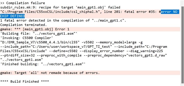

  • Hi Ming-Wei,
    I attempted to use the C55xCSL you provided, but it might be because the versions of CCS I am using (V7.4 and V12.4) are too new, and they cannot import .pjt files. Therefore, I tried to adjust the Project Properties according to the .pjt file settings. Currently, I am encountering an issue (as shown in the image), where even though I have set the General to C5502, it still displays "Chip not defined".
    I also tried downloading a new version of CXL-Lowpower (03.08.01.00), but it seems that the examples included do not support the C5502. Do you have any suggestions?

  • Hi Jun Ting,
    Since the C55XXCSL uses the CCS 3.3 project format, please import the CCS project from "Import Legacy CCSv3.3 Project". I have tested it, it works.

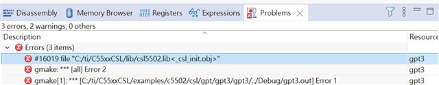

  • Hi Jun-ting,
    The main build errors are not due to the missing XDAIS. It is due to missing csl5502.lib. You may need to check the library include paths and names in you CCS project settings and the environment variables.
    If you absolutely need XDAIS, please download and install XDAIS 7.24.00.04 and hope it will work backward compatible with your CCS project.

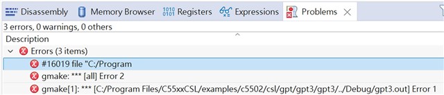

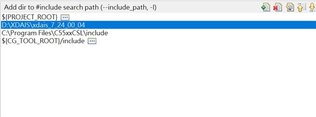

  • Hi Ming-Wei,
    I've attempted to correctly link all the include folders as shown in the attached image, and I have also downloaded the XDAIS version 7.24.00.04 that you mentioned. However, it seems that CCS is unable to recognize the newer version of XDAIS and continues to prompt me for XDAIS 1.0.0.
    Could there be an issue with my CCS settings? How should I modify the settings in CCS versions 7.4 and 12.4?
    Thank you for your assistance!
    Jun Ting
  • Hi Jun-ting,
    Can you deselect the XDAIS 1.0.0 to try again?

  • Hi Jun-ting,
    As I mentioned in previous post, the build errors are not due to the missing XDAIS. It is due to missing csl5502.lib. You may need to check the library include paths and names in you CCS project settings and the environment variables to make sure the csl5502.lib is actually linked to the CCS project.
    Ming

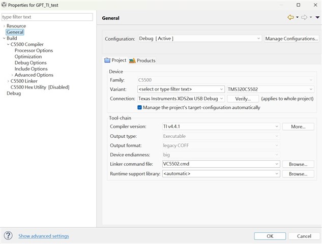

  • Hi Jun-Ting,
    Here are my settings for the gpt3 under CCS 10.4.0:
    I noticed that your "include library file or command file as input" is incorrect. Only the library names here, No path names.
    I was able to import /build (CCS 3.3) the mcbsp1 with the following changes:
    Ming

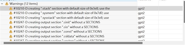

    I apologize for the confusion; I couldn't quite discern the differences between the two sets of images you provided. Could you please share your variable settings? I'm having trouble finding a "library" folder and files in the XDAIS_7_24_00_04 directory, so I tried adding the folder containing csl5502.lib to the variable fields based on the error messages, but it seems to have no effect.
    Additionally, I'd like to report something else. I found that if I do not specify the C5502 and USB2xx debug probe, and instead use a Custom C5500 Device, the Error I mentioned does not occur, but Warnings appear instead.

  • Hi Jun-Ting,
    1. The first set of images are for the gpt3 project build. The second set of images are for the mcbsp1 project. I am not sure what variable settings you were asking for
    2. the warnings are fine. It basically saying there those sections are not specified in the inker command file, so the linker will assign them to the default memory locations.

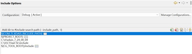

  • Hi Ming-Wei,
    Following your suggestion, I attempted to modify the paths in the Include options and File search paths, but I am unsure if these specific paths align with yours. I believe I need the paths for the following variables:

  • Hi Jun-Ting,
    There are two changes needed (both showed in my above screen captures):
    1. From ${C5500_CSL_CG_ROOT}/include to C:\ti\C55xxCSL\include (for compiler)
    2. From ${C5500_CSL_CG_ROOT}/lib to C:\ti\C55xxCSL\lib  (for Linker)
    Assuming your CSL is installed at C:\ti\C55xxCSL

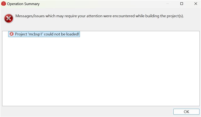

  • Hi Ming-Wei,
    Thank you for your guidance. I deleted all projects and re-imported mcbsp1, making only the two path changes you suggested. I am pleased to inform you that I was able to build successfully.
    However, I am now encountering two types of errors when I press "debug" in CCS:
    1. An error while executing [please attach the screenshot here], followed by a "Trouble reading memory" issue when I press "continue".
    2. An "Error -1143" appears right after establishing a debug session.
    Could you please provide your insight on these issues?
    Jun Ting
  • Hi Jun-Ting,
    The error message above is the GEL file c5502.gel line 202 which is part of the Init_CE0_SDRAM_5502CPUBoard() for EMIF initialization. Do you have external memory connected to the EMIF? If not, you can comment out the following lines from OnTargetConnect and OnReset:
    Init_CE1_SBSRAM_5502CPUBoard();
    Init_CE0_SDRAM_5502CPUBoard();
    Ming
  • Hi Ming-Wei,
    I have finally discussed the issue with the hardware provider. The main reason for the "Trouble Reading/Write memory problem" is that the "Watchdog Timer" on the customized board performed a hardware initialization on the DSP board.
    Jun Ting
