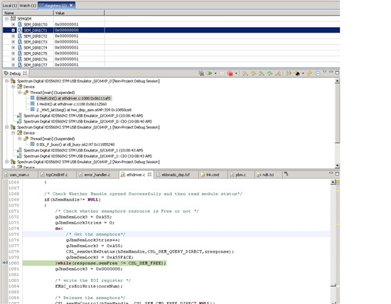

6474 NDK 2.0.0 Deadlock high throughput loads
I am using the 6474 DSP and am working with NDK_2_0_0 and with high throughput loads the NDK gets stuck in HWRxInt() in ethdriver.c.  I have attached a screen shot below.  I read this post(http://e2e.ti.com/support/dsp/c6000_multi-core_dsps/f/439/t/51491.aspx?PageIndex=2) which states that if I move NDK_PACKETMEM to L2RAM these lockups should not occur.  I have tried moving NDK_PACKETMEM in both DDR and L2RAM.  Can you provide some guidance on how I can fix this problem.
Nick
