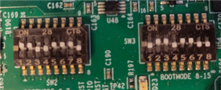

I have problems understanding how backup boot mode works/how I can trigger falling into this backup boot mode. Originally in our application we intend to boot in xSPI mode and fallback to SD-Boot if necessary. If read the corresponding parts in chip documentation and saw the following bootmode pin mapping table:
According to this the correct settings would be the following: 00 1 101 100 1110 011
This will primarily boot in xSPI mode and as fallback SD-Boot will be configured.

- I selected the BOOTMODE Pin config as stated above (00 1 101 100 1110 011)
- I would then expect to get the same output as a normal boot on SD, but I did not get anything?

  • I am now able to successfully fall back to SBL Null on SD-Card with this DIP switch setting:
    The backup boot mode works as expected if there is no image on Flash.

  • Hi Dominik,
    Glad to know it worked. What was the issue before? The previously shared boot mode looks same as the picture.

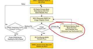

    Now I just need to find out if I can fallback from SBL OSPI also or if it is only allowed directly from RBL before SBL even started
    Yes, the primary and backup boot media option is read by ROM bootloader from the boot mode pin settings.
    This cannot be supported from SBL. For SBL, the user can pre-decide and flash the binaries into the required boot media. There are separate SBL examples to support each of them.

  • Hi Aparna,
    Yes they are the same, however I had a problem with Micro-USB cable, but it seems to work as expected on AM64x-EVM now.
    Alright good to know, then we need to cope differently with the situation. We planned to use a modified version of SBL OSPI and if there are any problems in loading a valid application image we wanted to fall back to backup boot mode. But as far as I understand now this will not be possible, is this correct?
    It will only be possible if the SBL OSPI itself would delete the flash at offset 0x0 (delete itself), then after next powercycle we will enter backup boot mode
  • Yes, your understanding is correct.
    You can refer the SBL code and make modifications according to your requirements.
