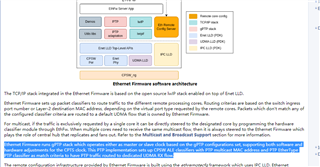

I want to know if SDK_8.05 supports the gPTP protocol stack? Or as I noticed in the example, only PTP protocol stack is supported.
TI RTOS SDK has PTP stack in 8.5 SDK.
EthFw application for CPSW9G using PTP stack for Timesync with External Network.
Note:
The PTP stack in SDK 8.5 is not for production support, it is only for test purpose.
TI Latest SDK 9.2 has PTP example from PDK ENT module with Production support gPTP Stack.

Does the PTP referred to here refer to the PTP protocol stack or the gPTP protocol stack? We may need to use the gPTP protocol stack。Does SDK 9.1 also support it? I saw in SDK 9.1 that r5f seems to have an integrated gPTP protocol stack. Does Linux need a kernel in 9.2 to support the GPTP protocol stack?
Its gPTP protocol stack.
Yes, We have support from SDK 9.0.
Latest SDKs addresses bug identified in older SDKs and feature enhancements.
Linux will not use PTP protocol stack shown above, it will part of Linux kernel.
