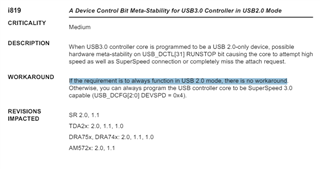

  • Kataoka-san,
    Is this issue relevant to the following article?
    Depends on the USB port that you are using.. Are you using USB1? If you are using USB2, then it should not be a factor.
    Also, who is the host? is it a PC?
    Are all the HW connections the same as the reference TI boards? Is there anything different?
    -Josue

    If this Errata is the cause, is there any way to avoid it?
    Koichi Kataoka
  • Hello Kataoka-san,
    Still not sure that this errata is the cause on my side but it seems possible.
    If it is the errata then there is no workaround:
    other then using the port as USB 3.0 SS permanently, or if available, use USB2.
    Josue
  • Kataoka-san,
    I had an internal conversation with our USB dwc3 maintainer and here are the 2 main points:
    • Unlikely that the errata is at play here since it would fail at the speed negotiation stage from the very beginning.
    • 2, TI nor Linux has a gadget driver for USBTMC class Device.
    So the question is, where did they find the code to enable the AM57x as a USBTMC device?
    As far as TI goes this feature is not supported within our SDK. From the log shared, it seems like whichever driver they are using needs to debugged in order to fix the issue.
    Josue

  • Kataoka-san,
    Let me confirm.
    If Errata is the cause, does this mean that the speed negotiation stage will result in an error?
    Yes. The speed negotiation is done by the time you reach the error.
