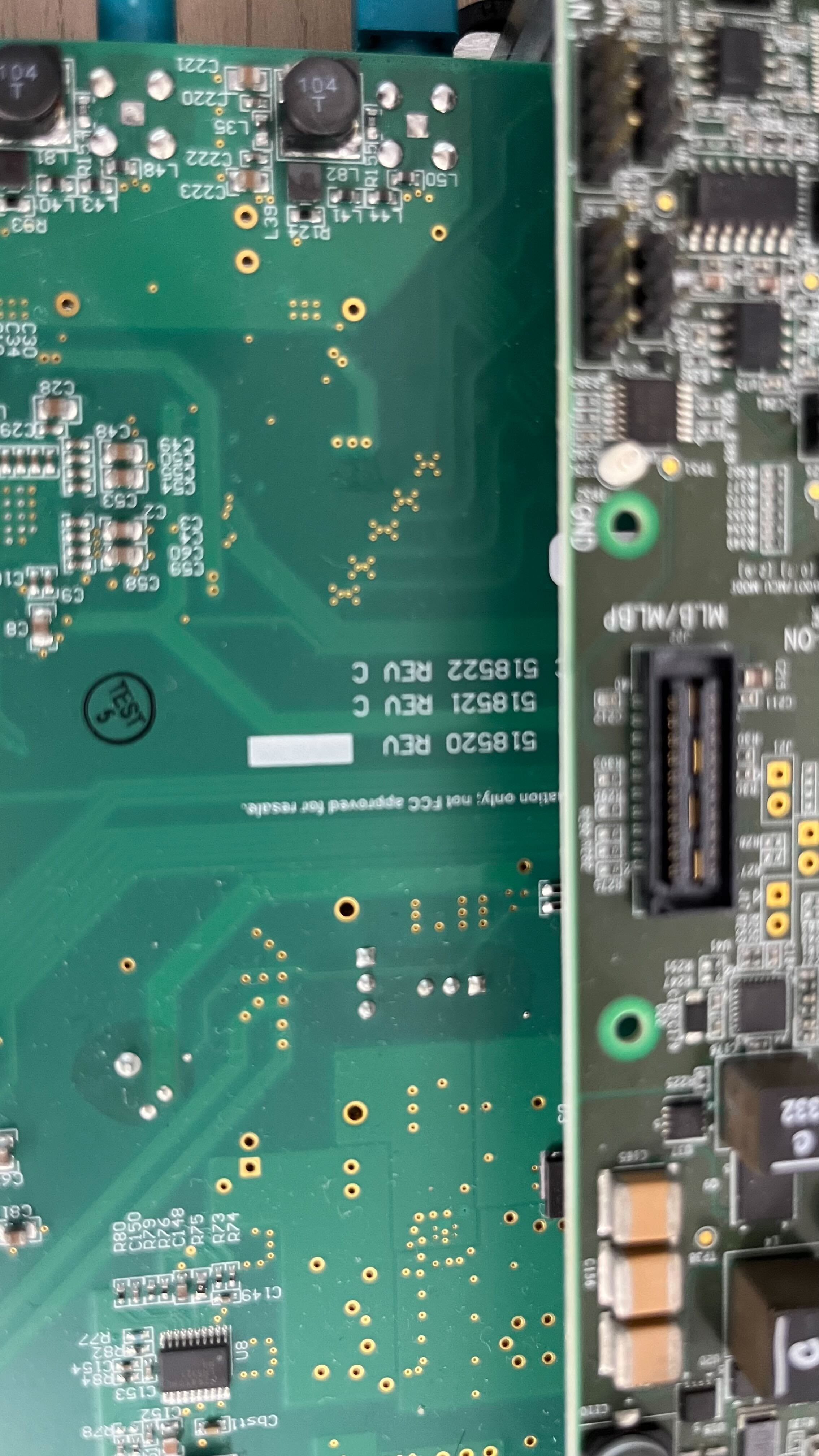

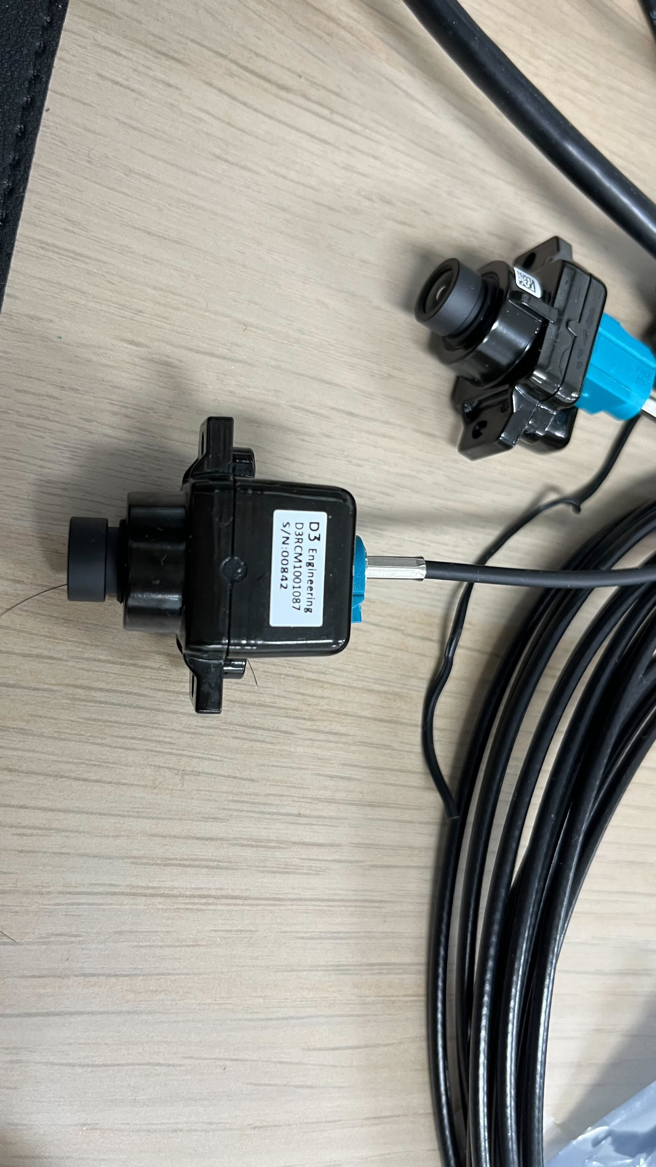

    Could you please check below pictures for their fusion board version and camera connection?
    For display issue, I found they connected DP1 port and will try it to connect DP0 as you suggested.
    Thanks and Best Regards,
    SI.
  • Hi SI,
    This is the fusion 1 board.
    Please check if the sensor is connected correctly onto the fusion 1 board. (i.e. please check for loose wires / connections) as the Deserializer is probed fine but the sensor and serializer is not. So the connection is the only suspision as this works at my end on the J721s2 EVM.
    Could you please check this?
    Nikhil

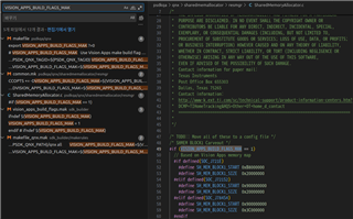

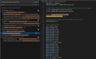

    But, they are curious why below memory allocation error occurred and want to check if memory modification required in QNX SDK.
    Could you please check if there anything to be modified for memory allocation in QNX SDK to run vision APPs?

    Here, the below logs means that you do not have sufficient space in DDR_SHARED_MEM. Have you made any memory modification to the default vision_apps SDK?
    MEM: allocation of size 3182784 failed with status -1
    49.894304 s: VX_ZONE_ERROR:[tivxMemBufferAlloc:87] Shared mem ptr allocation failed
    49.894326 s: VX_ZONE_ERROR:[ownAllocImageBuffer:316] could not allocate memory
    If not, please check if you have enabled to macro VISION_APPS_BUILD_FLAGS_MAX, to select vision_apps memory map in sharedmemallocater
    Nikhil
  • hi. Nikhil.
    Thank you for reply.
    Does what you mentioned mean that "VISION_APPS_BUILD_FLAGS_MAX =VISION_APPS_BUILD_FLAGS_MAK"?
    If VISION_APPS_BUILD_FLAGS_MAX is correct, please let me know where it is located, as I could not find it.
    Please check it again.
    Alren yang.
    Sorry for the typo, it is VISION_APPS_BUILD_FLAGS_MAK as you mentioned
    Is this enabled as part of your build?
    Also Have you made any memory modification to the default vision_apps SDK?
    Nikhil
  • Hi. Nikhil Dasan.
    VISION_APPS_BUILD_FLAGS_MAK is already enabled, and I am sending you the new log.
    This issue needs to be resolved before it can be applied to the new target board.
    Please let me know the issue.
    Alren yang.
