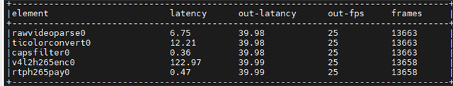

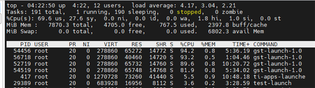

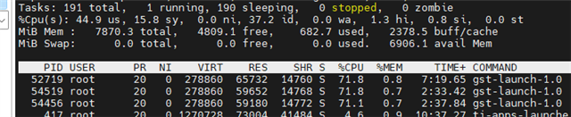

Our project needs to encode and output 4 channels of 1920*1536@25 video streams.I'm going to test the CPU load by starting four processes using the following pipeline command.When I started the three processes, the top result was as shown in the first graph, the total CPU load was about 60%。However, when the command is run to start the fourth process, the total CPU load suddenly spikes to 100%, as shown in the second graph. Why is the CPU load so high after the fourth process starts? Is there any way to reduce the CPU load or suggestions for optimizing my pipeline commands?
