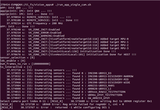

      I am using TDA4H EVM and FPD Link III board for our developments. Recently we purchased FPD Link IV (J7EXPAXEVM) board and want to interface this with EVM. Is there any specific steps/settings we have to do?
We are using latest SDK and QNX for developments.

  • Hi Nikhil,
      When we run single cam app with FPD Link IV board we are getting below output, also attached is the init log. Please let me know if you need any other info.

    J784S4-EVM@QNX:/ti_fs/vision_apps# ./run_app_single_cam.sh
    APP: Init QNX ... !!!
    appIpcInit: IPC: Init QNX ... !!!
    appIpcInit: IPC: Init ... Done !!!
        44.915652 s: REMOTE_SERVICE: Init ... !!!
        44.915782 s: REMOTE_SERVICE: Init ... Done !!!
        44.915813 s: GTC Frequency = 200 MHz
    APP: Init ... Done !!!
        44.915840 s:  VX_ZONE_INIT:Enabled
        44.915854 s:  VX_ZONE_ERROR:Enabled
    Thanks and Regards,
    Vineeth
  • Hi Vineeth,
    I think it didn't detect fusion board 2 here.
    Could you try making the below change in the API IssSensor_DeserializerInit() in imaging/sensor_drv/src/iss_sensors.c
    bDet = Board_detectBoard(BOARD_ID_FUSION2)
    if(1)
        issLogPrintf("Fusion2 Board Detected, using Fusion2 configuration\n");
        gFusionDet = vx_true_e;
    else
        issLogPrintf("Fusion1 Board configuration\n");
        gFusionDet = vx_false_e;
    If the above works, then the follow the below steps to flash the board ID
    Please check the attached board ID programmer for Fusion2 board which you can run on J784S4 EVM. Please follow below steps
    /cfs-file/__key/communityserver-discussions-components-files/791/j784s4_5F00_evm_5F00_fusion2_5F00_board_5F00_id_5F00_programmer.zip
    • Copy binaries from attached package to SD card and insert the card into EVM SD slot
    • Configure the EVM for SD boot mode
    • Connect the Main UART port (J49) of the board to PC and configure the serial console application to connect to main UART8 port
    • Power ON the board
    • Log shall appear on Main UART8 console prompting for entering the board serial number
    • Enter the board serial number (See the serial number sticker pasted on Fusion2 board)
    • Confirm there are no errors displayed in the log
    Please check if Board_detectBoard function is able to detect the Fusion2 board after above programming.
    Nikhil
