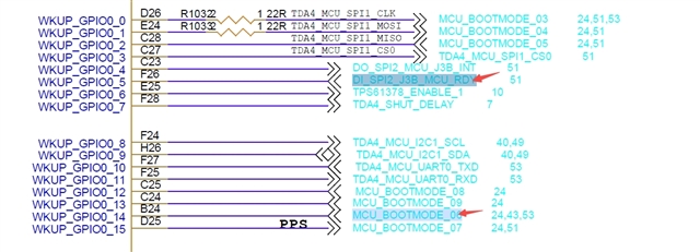

TDA4AL-Q1: TDA4AL-Q1: wkup_gpio0 driver init interrupts failed
Part Number: TDA4AL-Q1
DTS donfig:
kernel print log:
    What image are you running?
    Jared
  • this sdk versions:  ti-processor-sdk-linux-j721s2-evm-08_06_01_02
    Can you try running 9.2?
    Jared
  • Hi ,Jared
        The company project  chose to use this 8.6 version of the sdk, And did some adaptive development.
        so it's not easy to run 9.2,I hope solve the problem in running 8.6
    I am unable to reproduce the issue with the default image. Do you see the issue with the default image as well, or just with your custom image?
    Additionally, can you send the entirety of the dmesg logs?

    Yes, this is a custom image for a custom board. below is device tree.
    a. k3-j721s2-common-proc-board-uarts.dts
    // SPDX-License-Identifier: GPL-2.0
     * DT Overlay File for extending mcu uart 0 and wkup uart 0 support to kernel
     * for J721S2 SOC
     * Copyright (C) 2023 Texas Instruments Incorporated - https://www.ti.com/
    /dts-v1/;
    /plugin/;
    #include <dt-bindings/pinctrl/k3.h>
    	fragment@4 {
    		target-path = "/";
    		__overlay__ {
    			aliases {
    				serial0 = "/bus@100000/bus@28380000/serial@42300000";
    				serial1 = "/bus@100000/bus@28380000/serial@40a00000";
    &wkup_pmx0{
    	mcu_uart0_pins_default: mcu-uart0-pins-default {
    		pinctrl-single,pins = <
    			J721S2_WKUP_IOPAD(0x0f8, PIN_INPUT, 0) /* (B24) WKUP_GPIO0_14.MCU_UART0_CTSn */
    			J721S2_WKUP_IOPAD(0x0fc, PIN_OUTPUT, 0) /* (D25) WKUP_GPIO0_15.MCU_UART0_RTSn */
    			J721S2_WKUP_IOPAD(0x0f4, PIN_INPUT, 0) /* (C24) WKUP_GPIO0_13.MCU_UART0_RXD */
    			J721S2_WKUP_IOPAD(0x0f0, PIN_OUTPUT, 0) /* (C25) WKUP_GPIO0_12.MCU_UART0_TXD */
    &mcu_uart0 {
    	status = "okay";
    	pinctrl-names = "default";
    	pinctrl-0 = <&mcu_uart0_pins_default>;
    &wkup_pmx0 {
    	wkup_uart0_pins_default: wkup-uart0-pins-default {
    			J721S2_WKUP_IOPAD(0x0d8, PIN_INPUT, 0) /* (E25) WKUP_GPIO0_6.WKUP_UART0_CTSn */
    			J721S2_WKUP_IOPAD(0x0dc, PIN_OUTPUT, 0) /* (F28) WKUP_GPIO0_7.WKUP_UART0_RTSn */
    			J721S2_WKUP_IOPAD(0x0b0, PIN_INPUT, 0) /* (D28) WKUP_UART0_RXD */
    			J721S2_WKUP_IOPAD(0x0b4, PIN_OUTPUT, 0) /* (D27) WKUP_UART0_TXD */
    &wkup_uart0 {
    	status = "okay";
    	pinctrl-0 = <&wkup_uart0_pins_default>;
    b. k3-j721s2-common-proc-board.dts
     * Copyright (C) 2021 Texas Instruments Incorporated - https://www.ti.com/
     * Common Processor Board: https://www.ti.com/tool/J721EXCPXEVM
    /dts-v1/;
    #include "k3-j721s2-som-p0.dtsi"
    #include <dt-bindings/net/ti-dp83867.h>
    #include <dt-bindings/phy/phy-cadence.h>
    #include <dt-bindings/phy/phy.h>
    #include <dt-bindings/mux/ti-serdes.h>
    #include "k3-j721s2-rtos-memory-map.dtsi"
    	compatible = "ti,j721s2-evm", "ti,j721s2";
    	model = "Texas Instruments J721S2 EVM";
    	chosen {
    		stdout-path = "serial2:115200n8";
    		bootargs = "console=ttyS2,115200n8 earlycon=ns16550a,mmio32,0x2880000 root=/dev/mmcblk0p2 rw rootfstype=ext4 rootwait";
    	aliases {
    		serial2 = &main_uart8;
    		serial3 = &main_uart2;
    		serial4 = &main_uart5;
    		mmc0 = &main_sdhci0;
    		mmc1 = &main_sdhci1;
    		can0 = &main_mcan16;
    		can1 = &mcu_mcan0;
    		can2 = &mcu_mcan1;
    		can3 = &main_mcan3;
    		can4 = &main_mcan5;
    		ethernet1 = &main_cpsw_port1;
    	evm_12v0: fixedregulator-evm12v0 {
    		/* main supply */
    		compatible = "regulator-fixed";
    		regulator-name = "evm_12v0";
    		regulator-min-microvolt = <12000000>;
    		regulator-max-microvolt = <12000000>;
    		regulator-always-on;
    		regulator-boot-on;
    	vsys_3v3: fixedregulator-vsys3v3 {
    		/* Output of LM5140 */
    		regulator-name = "vsys_3v3";
    		regulator-min-microvolt = <3300000>;
    		regulator-max-microvolt = <3300000>;
    		vin-supply = <&evm_12v0>;
    		regulator-boot-on;
    	vsys_5v0: fixedregulator-vsys5v0 {
    		regulator-name = "vsys_5v0";
    		regulator-min-microvolt = <5000000>;
    		regulator-max-microvolt = <5000000>;
    		regulator-boot-on;
    	vdd_mmc1: fixedregulator-sd {
    		/* Output of TPS22918 */
    		regulator-name = "vdd_mmc1";
    		regulator-boot-on;
    		enable-active-high;
    		vin-supply = <&vsys_3v3>;
    		gpio = <&exp2 2 GPIO_ACTIVE_HIGH>;
    		status = "disabled";
    	vdd_sd_dv: gpio-regulator-TLV71033 {
    		/* Output of TLV71033 */
    		compatible = "regulator-gpio";
    		regulator-name = "tlv71033";
    		pinctrl-0 = <&vdd_sd_dv_pins_default>;
    		regulator-min-microvolt = <1800000>;
    		regulator-boot-on;
    		vin-supply = <&vsys_5v0>;
    		gpios = <&main_gpio0 8 GPIO_ACTIVE_HIGH>;
    		states = <1800000 0x0>,
    			 <3300000 0x1>;
    	transceiver1: can-phy1 {
    		compatible = "ti,tcan1043";
    		#phy-cells = <0>;
    		max-bitrate = <5000000>;
    		pinctrl-0 = <&mcu_mcan0_gpio_pins_default>;
    		standby-gpios = <&wkup_gpio0 69 GPIO_ACTIVE_LOW>;
    		enable-gpios = <&wkup_gpio0 0 GPIO_ACTIVE_HIGH>;
    	transceiver2: can-phy2 {
    		compatible = "ti,tcan1042";
    		#phy-cells = <0>;
    		pinctrl-0 = <&mcu_mcan1_gpio_pins_default>;
    		standby-gpios = <&wkup_gpio0 2 GPIO_ACTIVE_HIGH>;
    	transceiver3: can-phy3 {
    		#phy-cells = <0>;
    		standby-gpios = <&exp2 7 GPIO_ACTIVE_LOW>;
    		enable-gpios = <&exp2 6 GPIO_ACTIVE_HIGH>;
    		mux-states = <&mux0 1>;
    	transceiver4: can-phy4 {
    		#phy-cells = <0>;
    		standby-gpios = <&exp_som 7 GPIO_ACTIVE_HIGH>;
    		mux-states = <&mux1 1>;
    	dp0_pwr_3v3: fixedregulator-dp0-prw {
    		regulator-name = "dp0-pwr";
    		gpio = <&exp4 0 0>;	/* P0 - DP0_PWR_SW_EN */
    		enable-active-high;
    	dp1_pwr_3v3: regulator-dp1-prw {
    		regulator-name = "dp1-pwr";
    		gpio = <&exp4 1 GPIO_ACTIVE_HIGH>; /* P1 - DP1_PWR_SW_EN */
    		enable-active-high;
    	dp0: dp0-connector {
    		compatible = "dp-connector";
    		label = "DP0";
    		type = "full-size";
    		dp-pwr-supply = <&dp0_pwr_3v3>;

  • Hi Jared,
    I do the test this not running mcu10, A core wkup_gpio0 driver init interrupts is succeed.
    mcu10 also used the two pin of wkup_gpio0 as interrupts gpio, is this influence the A core wkup_gpio0 register interrupts ?
    It looks like you may have a conflict. If you're defining the pinmux for a pin in two different locations at the same time, you'll run into issues. You need to disable one.
    Jared
  • Hi Jared,
    MCU10 need used WKUP_GPIO0_5  as interrupts pin ,and  A core need used WKUP_GPIO0_14 as  interrupts pin,this can lead to conflicts。
    WKUP_GPIO0_5 and   WKUP_GPIO0_14 in a set of interrupts source.  I don't want to change the hardware .What can be done to solve this problem?
    Are you trying to use two different functions on the pins? If not, simply remove/disable the unused function from the device tree.
    Jared
