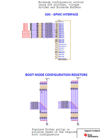

Hi TI Experts,
Do you have suggestions to optimize the BOOTMODE configuration on custom board compared to  implementation on the SK or the EVM schematics.
Can i remove the buffers. If yes, do you have some implementation guidance
