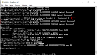

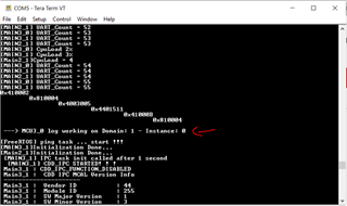

  • By "Not properly set", I mean that the log message is sent through the default uart serial port instead of the wkup_uart.
    As you mentioned, I am trying get UART logs on wkup_uart. I applied the patch, and I got the same behavior. The first log is sent through the default serial port and the second one through wkup_uart, but both of them should be sent through wkup_uart.

    Default UART port logs
    wkup_uart port logs
