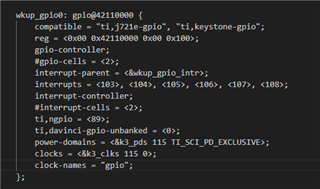

Hi expert,
Our customer found the WKUP_GPIO0 interrupt register fails as below, while the Main GPIO is OK. The SDK version is 8.6. Could you please help to check the reason? Thanks

  • Hi Xingyu Zhu,
    Can you share the complete boot logs? Is this also seen on latest 9.2 SDK as well?
    - Keerthy
  • Please try once with the below change on 8.6:
    diff --git a/arch/arm64/boot/dts/ti/k3-j721s2-mcu-wakeup.dtsi b/arch/arm64/boot/dts/ti/k3-j721s2-mcu-wakeup.dtsi
    index 60e60cd76..b275886c9 100644
    --- a/arch/arm64/boot/dts/ti/k3-j721s2-mcu-wakeup.dtsi
    +++ b/arch/arm64/boot/dts/ti/k3-j721s2-mcu-wakeup.dtsi
    @@ -92,7 +92,7 @@
                    #interrupt-cells = <1>;
                    ti,sci = <&sms>;
                    ti,sci-dev-id = <125>;
    -               ti,interrupt-ranges = <16 960 16>;
    +               ti,interrupt-ranges = <16 928 16>;
    - Keerthy
  • Hi Keerthy,
    Thanks for your reply. But the patch didn't work. Below is the boot logs.

    I've located the cause of the problem. below is detail.
    MCU10 need used WKUP_GPIO0_5  as interrupts pin ,and  A core need used WKUP_GPIO0_14 as  interrupts pin,this can lead to conflicts。
    WKUP_GPIO0_5 and   WKUP_GPIO0_14 in a set of interrupts source.  I don't want to change the hardware .What can be done to solve this problem?
    Whether MCU and A core can use GPIO interrupt sources at the same time?
  • No. One Gpio module can either be owned by MCU or A core. Linux running on A core supports banked interrupts. 5 and 14 are in the same bank. Recommend using main domain Gpio on one of the cores.
    Keerthy
