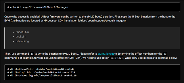

  • Hello Prashant,
    Please flash the rootfs filesystem into the partition from which you are trying to boot.
    I am glad to see you again, as you said to flash the roofs file system into the partition, so i am copying the image from sd card to emmc then from emmc i am trying to boot the board so while Flashing Kernel, Device Tree and Root File system to eMMC for that particular partition first using sd card i have to go to the u-boot and first i will do the emmc partition and then i have to go to root and then i have to flash!
    xzcat -dc phytec-qt5demo-image-phyboard-lyra-am62xx-2.wic.xz | dd of=/dev/mmcblk0 bs=4M conv=fsync
    Here, instead of /dev/mmcblk0 i have to give that particular partition from which i am trying to boot
    Am i correct no!
  • Hi Suraj,
    The WIC image is a disk image. This means it itself defines the partition layout & accordingly contains the filesystem image. At least this is the case with the WIC images we provide.
    For flashing rootfs from SD card to eMMC, you may follow the below guide
    https://dev.ti.com/tirex/content/am62x_academy_9_02_00_00_v1/_build_am62x_academy_9_02_00_00_v1/source/linux/ch-develop/dev-flash-linux-emmc.html#flash-kernel-device-tree-and-root-filesystem-to-emmc
    On another note, may I know why are you choosing to flash to eMMC from SD card?
    According to your previous threads, I know you already have EXT4 filesystem for your rootfs and flashed it over DFU. So, you may use the same procedure to flash to 2nd partition of your eMMC UDA.
    Prashant

  • Hello Prashant,
    I flashed EXT4 filesystem image (.ext4) to the mmcblk0p2 partition and i have another rootfs partition (mmcblk0p3) in that also i was trying to flash the image but it is showing kernel panic, i have attached log also, so what i need to do please assist.
    My objective is to flash two different images into two different rootfs partition and then need to boot the board from any one of them based on what am i choose the option but should boot the board from both partitions.
    agl-ivi-demo-platform-flutter-am62xx-evm-20240724073304.rootfs.wic.xz  rootfs.ext4

    Now, since you have partitioned using GPT partition table, you may not flash the bootloader images to the eMMC UDA first partition (mmcblk0p1) because the AM62x ROM doesn't support booting from GPT partitions.
    Instead, you should flash the U-Boot images to eMMC Boot0 partition and use the eMMC alternate bootmode.
    The procedure to flash the U-Boot images to eMMC Boot0 partitions is described here
     https://dev.ti.com/tirex/content/am62x_academy_9_02_00_00_v1/_build_am62x_academy_9_02_00_00_v1/source/linux/ch-develop/dev-flash-linux-emmc.html#flash-u-boot-to-emmc
    Prashant
  • Hello Prashant,
    dev.ti.com/.../dev-flash-linux-emmc.html
    I followed this and then ext4 partition is created,
    tar -xvf ~/<Linux image file copied from the host> after this it's extracting but at the last moment is showing
