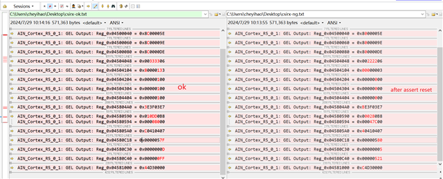

Hi, TI experts,
We want to reset csirx on our tda4ve board by following below steps:
CameraFxns_4_to_1.streamOff(0);
appLogWaitMsecs(1);
/* Stop streams only if this is last active Virtual context */
*((volatile unsigned int *)(0x04504100)) = 0x02;
/* Stop all virtual channel */
/* VC0 */
regval = *((volatile unsigned int *)(0x04500020));
*((volatile unsigned int *)(0x04500020)) = (regval & 0x7FFFFFFF);
/* VC1 */
regval = *((volatile unsigned int *)(0x04500040));
*((volatile unsigned int *)(0x04500040)) = (regval & 0x7FFFFFFF);/* VC2 */
regval = *((volatile unsigned int *)(0x04500060));
*((volatile unsigned int *)(0x04500060)) = (regval & 0x7FFFFFFF);
/* VC3 */
regval = *((volatile unsigned int *)(0x04500080));
*((volatile unsigned int *)(0x04500080)) = (regval & 0x7FFFFFFF);
appLogWaitMsecs(10);
/* assert pixel interface reset */
regval = *((volatile unsigned int *)(0x04500010));
*((volatile unsigned int *)(0x04500010)) = (regval & 0xFFFFFFFE);
/* reset streams before configuration */
*((volatile unsigned int *)(0x04504100)) = 0x10;
regval = *((volatile unsigned int *)(0x04504104));
/* Wait for stream to become IDLE */
while (((regval & (1 << 8))!= 0x0U) && ((regval & (0xF << 4)) != 0x0U))
/* Enable DMA context for PSIL thread */
/* VC0 */
*((volatile unsigned int *)(0x04500020)) = (regval | 0x80000000);
/* VC1 */
*((volatile unsigned int *)(0x04500040)) = (regval | 0x80000000);
/* VC2 */
*((volatile unsigned int *)(0x04500060)) = (regval | 0x80000000);
/* VC3 */
*((volatile unsigned int *)(0x04500080)) = (regval | 0x80000000);
/* start streams */
*((volatile unsigned int *)(0x04504100)) = 0x01;
CameraFxns_4_to_1.streamOn(0);
buy afther doing above steps, the streams can not be recover.
can you help to find what was wrong?
log was attached below:
