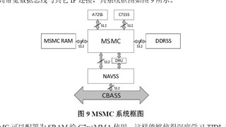

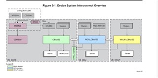

As shown in the below diagram, there are CBASS, NAVSS, MSMC and DDSS, and DDRSS is only connected to MSMC. Customer would like to know:
1. Regarding the above 2 patches, what is the function of NB and QoS config? Can it help MCU access DDR?
2. Besides the QoS, it there any other points they need to care and check?

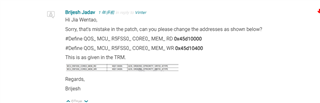

    Can you please try changing value in this register to 0x300070C0?
    Brijesh
  • Hi Brijesh:
                    We also tested the dma consistency type a few days ago, but it didn't work. I'll post the entire file here to see if there's any improvement. We didn't encounter this problem before using TDA4VM sdk0703, but now we have this problem using TDA4AL 0806sdk. Please help analyze it.
                     The file I changed is here

    #define QOS_MCU_R5FSS0_CORE0_MEM_RD_ATYPE    (3U)
    #define QOS_MCU_R5FSS0_CORE0_MEM_WR_ATYPE    (3U)
    #define QOS_MCU_R5FSS0_CORE0_MEM_RD_ORDER_ID (12U)
    #define QOS_MCU_R5FSS0_CORE0_MEM_WR_ORDER_ID (12U)
    #define QOS_MCU_R5FSS0_CORE0_MEM_RD_PRIORITY (7U)
    #define QOS_MCU_R5FSS0_CORE0_MEM_WR_PRIORITY (7U)
    #define QOS_MCU_R5FSS0_CORE0_MEM_RD                     0x45d10000
    #define QOS_MCU_R5FSS0_CORE0_MEM_RD_NUM_J_CH            1
    #define QOS_MCU_R5FSS0_CORE0_MEM_RD_NUM_I_CH            1
    #define QOS_MCU_R5FSS0_CORE0_MEM_RD_CBASS_GRP_MAP1(j)   (QOS_MCU_R5FSS0_CORE0_MEM_RD + 0x0 + (j) * 8)
    #define QOS_MCU_R5FSS0_CORE0_MEM_RD_CBASS_GRP_MAP2(j)   (QOS_MCU_R5FSS0_CORE0_MEM_RD + 0x4 + (j) * 8)
    #define QOS_MCU_R5FSS0_CORE0_MEM_RD_CBASS_MAP(i)        (QOS_MCU_R5FSS0_CORE0_MEM_RD + 0x100 + (i) * 4)
    #define QOS_MCU_R5FSS0_CORE0_MEM_WR                     0x45d10400
    #define QOS_MCU_R5FSS0_CORE0_MEM_WR_NUM_J_CH            1
    #define QOS_MCU_R5FSS0_CORE0_MEM_WR_NUM_I_CH            1
    #define QOS_MCU_R5FSS0_CORE0_MEM_WR_CBASS_GRP_MAP1(j)   (QOS_MCU_R5FSS0_CORE0_MEM_WR + 0x0 + (j) * 8)
    #define QOS_MCU_R5FSS0_CORE0_MEM_WR_CBASS_GRP_MAP2(j)   (QOS_MCU_R5FSS0_CORE0_MEM_WR + 0x4 + (j) * 8)
    #define QOS_MCU_R5FSS0_CORE0_MEM_WR_CBASS_MAP(i)        (QOS_MCU_R5FSS0_CORE0_MEM_WR + 0x100 + (i) * 4)

  • Hi Gaston yan,
    The changes look fine to me.
    Any specific reason you want to change priority for main domain R5F also? Can you try commenting out call to setup_main_r5f_qos and see if it helps?
    Brijesh
  • Hi :
                   We didn't verify it properly at the beginning, but now we find that my previous program is effective. This issue can be closed.
  • Thanks Gaston Yan, closing this ticket.
