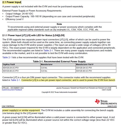

I have J784S4XEVM and as per user guide it is mentioned that the EVM requires and external power supply of 24-48 VDC with power capacity being 100-160 W (depending on use case and connected peripherals); I have an external power supply with maximum rating of 30 VDC & 10 A which can suffice the required power capacity of 100-160 W. I just want to confirm that even though it is mentioned to use 24-48 VDC can my present supply ratings should be sufficient for EVM?
