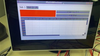

When I display solid color pictures, the LCD display is normal, when I display complex pictures, a blurry screen occurs.

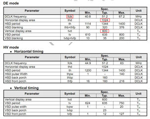

    What SDK baseline are you on and what changes have you made to your DT files? Also, have you probed the clocks and the data lines to ensure everything is latching on rising edge or falling edge and lcd timing are based on your LCD specs.
    Krunal
    1. The sdk is ti-processor-sdk-linux-am62xx-evm-09.02.01.10, the kernel source code is ti-linux-kernel-6.1.83
    2. The changes to the DT file are as follows:

    3. The changes to the panel-simple.c are as follows:
    static const struct drm_display_mode name_mode = {
    		.clock = 51200,
    		.hdisplay = 1024,
    		.hsync_start = 1024 + 160,
    		.hsync_end = 1024 + 160 + 10,
    		.htotal = 1024 + 160 + 10 + 160,
    		.vdisplay = 600,
    		.vsync_start = 600 + 15,
    		.vsync_end = 600 + 15 + 1,
    		.vtotal = 600 + 15 + 1 + 23,
    		.flags = DRM_MODE_FLAG_NVSYNC | DRM_MODE_FLAG_NHSYNC,
    static const struct panel_desc name_desc = {
    	.modes = &name_mode,
    	.num_modes = 1,
    	.bpc = 8,
    	.size = {
    		.width = 154,
    		.height = 86,
    	.bus_format = MEDIA_BUS_FMT_RGB888_1X24,
    	.connector_type = DRM_MODE_CONNECTOR_DPI,

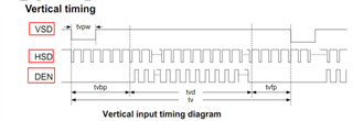

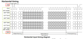

    4. The LCD data input format and timing are as follows:
    5. Measured by an oscilloscope, the data and sync are latching on falling edge
    By default, data will latch on rising edge and you already implemented the following in your code: https://e2e.ti.com/support/processors-group/processors/f/processors-forum/1228207/am62a7-rgb-display-flickering-and-pixel-issue/4687209#4687209
    Also, when you run kmstest, do the output and timing printed on console match your programming?

    We found the cause of the problem: the upper and lower 8 bits of RGB were reversed.
