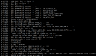

After porting patches  to run single_cam with TIOVX host in R5 (no A72 is used), we observe that it is taking too much time to provide an image to display (8s)
Currently, we are in the fastest solution, SBL, TIFS and APP in OSPI. Although it would be expected to be a good improvement, it is not. (with SD card is taking 11s).
I assure SBL is not providing UART debug messages, to speed up the process.
To understand where is taking most of the time in MCU2_0, I can see MCu2_0 is taking almost 5s since starting till image is in Display (4s from enumerating sensor to sensor initialization finishes)
Besides the possibility that I2C commands can be hard optimized to speed up sensor initialization, could you give any suggestion why is whole thing taking so long? Could you give tips to reduce this amount of time to achieve no more than 2-3 as it is achieved in SRV (e2e.ti.com/.../faq-tda4vm-how-to-optimize-surround-view-use-case-to-2-3-seconds-from-power-on)
Many thanks

    Could you share the full remote core logs that you are receiving currently in a text format (instead of screenshot)?
    Nikhil
  • Hi Nikhil, this is the full log of MCU_2_0.
    Thank you very much,
    Marco

    Please share the log shown in the screenshot where you have done the sensor configuration. The above logs do not have the same
    Nikhil

    What is from T5 to T6? I believe this is your application right? which involves configuration of sensor and deserializer?
    Nikhil
  • Hi Nikhil. Sorry for the delay ( I was sick...)
    No, this time is taken for the operation done by SDK solution (enumeration, deser init, ser init, send sensor configuration, etc) in J721EVM. I was warning you time ago:
    Any suggestion to reduce it in SDK?
