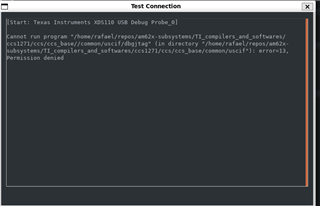

I'm running code composer in a linux environment, in a wsl. I'm using the target config that I used in my windows environment, which worked perfectly. However, in my wsl, it doesn't work after running the .desktop. The error is as follows:

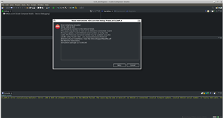

Error initializing emulator:
(Error -260 @ 0x0)
An attempt to connect to the XDS110 failed.
The cause may be one or more of: no XDS110 is connected, invalid
firmware update, invalid XDS110 serial number, or faulty USB
cable. The firmware and serial number may be updated using the
xdsdfu utility found in the .../ccs_base/common/uscif/xds110
directory of your installation. View the XDS110SupportReadMe.pdf
file there for instructions.
(Emulation package 12.7.0.00130)
I renamed my .desktop to ccs1271 and am using the gtk-launch command in the follow path:
/usr/local/share/applications

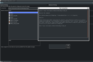

My target config is:
