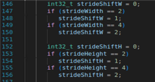

3. within MMALIB_CNN_convolve_row_ixX_ixX_oxX_d.c, the values of strideshift are less than stridewidth and stride height, please explain the significance of this change and what should this be in our case:

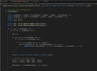

    Could you please elaborate on what exactly is the optimization performed for the kernel sizes for this API.
    The VXLIB_convolve_cn.cpp is what we would consider the "natural c" implementation, meaning this is the reference to how the algorithm works in c and is not optimized.
    For the optimized code see the VXLIB_convolve_ci.cpp file and let me know if you have further questions regarding the implementation that we can discuss.
