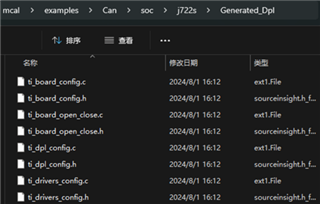

Dpl code is shown as figure. Do we need update these files when we add new module to example in EB?If so, how do we update these files?
Understood, these are generated by sysconfig files.
Can you please raise new thread related to sysconfig files support in mcusw. It is easy to track the issues each on different thread.
