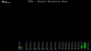

4. Finally, insert the SD Card into the TDA4VM EVB. After booting and logging in as root, execute the following command:
cd /opt/vision_apps
source ./vision_apps_init.sh
cd /opt/vision_apps
./vx_app_tidl_od.out --cfg app_od.cfg
result:
At this time, you will find that the screen is black, it seems that the EVB has crashed, no images can be seen, and there is no UART output.
How to troubleshoot this problem?

    When vx_app_tidl_od.out is executed, EVB will not be able to display the screen normally.
    root@j721e-evm:~# cd /opt/vision_apps
    root@j721e-evm:/opt/vision_apps# source ./vision_apps_init.sh
    root@j721e-evm:/opt/vision_apps# cd /opt/vision_apps
    root@j721e-evm:/opt/vision_apps# ./vx_app_tidl_od.out --cfg app_od.cfg
    If you restore the settings of tidl_config and tidl_network. That is, when set to tidl_io_peele_300_1.bin and tidl_net_peele_300.bin, the screen will display normally.
    So I guess there should be some problem with subgraph_0_tidl_io_1.bin and subgraph_0_tidl_net.bin but I don't know how to rule it out.

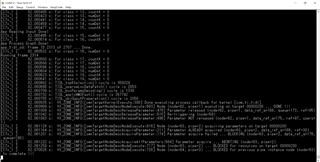

  • Hi Pratik Kedar,
    I found that the problem was at C7x_1.
    [C7x_1 ]    412.410605 s:  VX_ZONE_INFO:[ownTargetKernelExecute:398] Done executing process callback for kernel [com.ti.tidl]
    [C7x_1 ]    412.410640 s:  VX_ZONE_INFO:[ownTargetNodeDescNodeExecute:683] Node (node=62, pipe=1) executing on target 00000200 ... DONE !!!
    [C7x_1 ]    412.410680 s:  VX_ZONE_INFO:[ownTargetNodeDescReleaseParameter:478] Parameter released (node=62, pipe=1, data_ref_q=168, queue=173, ref=95)
    [C7x_1 ]    412.410708 s:  VX_ZONE_INFO:[ownTargetNodeDescReleaseParameter:515] Re-triggering (node=59)
    [C7x_1 ]    412.410750 s:  VX_ZONE_INFO:[ownTargetNodeDescReleaseParameter:496] Parameter NOT released (node=62, pipe=1, data_ref_q=175, ref=97, users=1)
    [C7x_1 ]    412.410795 s:  VX_ZONE_INFO:[ownTargetNodeDescNodeExecute:616] Node (node=63, pipe=2) acquiring parameters on target 00000200
    [C7x_1 ]    412.410830 s:  VX_ZONE_INFO:[ownTargetNodeDescAcquireParameter:211] Parameter ALREADY acquired (node=63, pipe=2, data_ref_q=169, ref=30)
    [C7x_1 ]    412.410867 s:  VX_ZONE_INFO:[ownTargetNodeDescAcquireParameter:174] Parameter acquire failed ... BLOCKING (node=63, pipe=2, data_ref_q=176, queue=180)
    [C7x_1 ]    412.410898 s:  VX_ZONE_INFO:[ownTargetNodeDescAcquireAllParameters:564] Parameter acquire ... ABORTING (node=63, pipe=2)
    [C7x_1 ]    412.410925 s:  VX_ZONE_INFO:[ownTargetNodeDescNodeExecute:717] Node (node=63, pipe=2) ... BLOCKED for resources on target 00000200
    [C7x_1 ]    412.419688 s:  VX_ZONE_INFO:[ownTargetNodeDescNodeExecute:726] Node (node=64, pipe=3) ... BLOCKED for previous pipe instance node (node=63) to complete !!!
    Can you help me and tell me how to solve this problem?
    Below is the complete serial port log.

  • Hi George,
    I want to summarize the current issues you are seeing and the steps you have taken so far - please correct me if any of the following is incorrect.
    1. You have a YOLOV5 model that is based of of edgeai-yolov5 examples, and you have confirmed that there is correct inference on edgeai-tidl-tools
      And confirm edgeai-tidl-tools/output_images/py_out_yolov5-ti-pld-20240521_ADE_val_00000000.jpg to confirm that the desired parking space corner is obtained.
    2. After changing the default configuration of the Deep Learning Object Detection demo application (linked here), to point to your model, you are not seeing any result from the screen
    3. You have tried running the default model that this demo application supports and are seeing the expected behavior.
      It was found that the code in drawBox() in /ti-processor-sdk-rtos-j721e-evm-09_02_00_05/vision_apps/kernels/img_proc/c66/vx_draw_box_detections_target.c was commented out.
      Not letting it do its original job doesn't have this problem.

                    vii. Confirmation screen and UART output.
                Result:
                    The screen display is as follows.
                    UART displays error message.
                        [C7x_1 ]     82.060935 s:  VX_ZONE_INFO:[ownTargetKernelExecute:398] Done executing process callback for kernel [com.ti.tidl]
                        [C7x_1 ]     82.060969 s:  VX_ZONE_INFO:[ownTargetNodeDescNodeExecute:683] Node (node=62, pipe=1) executing on target 00000200 ... DONE !!!
                        [C7x_1 ]     82.061009 s:  VX_ZONE_INFO:[ownTargetNodeDescReleaseParameter:478] Parameter released (node=62, pipe=1, data_ref_q=168, queue=173, ref=95)
                        [C7x_1 ]     82.061042 s:  VX_ZONE_INFO:[ownTargetNodeDescReleaseParameter:515] Re-triggering (node=59)
                        [C7x_1 ]     82.061083 s:  VX_ZONE_INFO:[ownTargetNodeDescReleaseParameter:496] Parameter NOT released (node=62, pipe=1, data_ref_q=175, ref=97, users=1)
                        [C7x_1 ]     82.061128 s:  VX_ZONE_INFO:[ownTargetNodeDescNodeExecute:616] Node (node=63, pipe=2) acquiring parameters on target 00000200
                        [C7x_1 ]     82.061164 s:  VX_ZONE_INFO:[ownTargetNodeDescAcquireParameter:211] Parameter ALREADY acquired (node=63, pipe=2, data_ref_q=169, ref=30)
                        [C7x_1 ]     82.061201 s:  VX_ZONE_INFO:[ownTargetNodeDescAcquireParameter:174] Parameter acquire failed ... BLOCKING (node=63, pipe=2, data_ref_q=176, queue=180)
                        [C7x_1 ]     82.061232 s:  VX_ZONE_INFO:[ownTargetNodeDescAcquireAllParameters:564] Parameter acquire ... ABORTING (node=63, pipe=2)
                        [C7x_1 ]     82.061259 s:  VX_ZONE_INFO:[ownTargetNodeDescNodeExecute:717] Node (node=63, pipe=2) ... BLOCKED for resources on target 00000200
                        [C7x_1 ]     82.070026 s:  VX_ZONE_INFO:[ownTargetNodeDescNodeExecute:726] Node (node=64, pipe=3) ... BLOCKED for previous pipe instance node (node=63) to complete !!!
                Expect:
                    The screen displays normally.
    5. Could you clarify if this is the remote core log from when you run the demo application with your model?
        george lin comment:
            Yes. The log is come from UART.
    Does the log hang after this point in a way that is unrecoverable?
        george lin comment:
            Yes, the program cannot be stopped via key x. Ctrl+c is required to stop this program execution.

  • Hi Nikhil,
    I found a deadlock in TIDL_process() (located in tidl_j721e_08_06_00_10/tidl/algo/src/tidl_alg.c).
    2233        if (intAlgHandle->isPreEmptionEnable)
    2234        {
    2235          if (TIDL_isThisLayerOptimalForPreemption(intAlgHandle->preEmptHandle, i))
    2236          {
    2237            /* Wait for layer padding DMA before restoring the interrupts */
    2238            TIDL_syncPadTransfer(intAlgHandle, trMem);
    2239            status = TIDL_updateContextMemPtrsForPreemption(&intAlgHandle->preEmptContextInfo, intAlgHandle->privContext,
    2240            intAlgHandle->preEmptHandle, intAlgHandle->perfSimOutput, intAlgHandle->sysScratchPtr.l2BasePtr,
    2241            intAlgHandle->sysScratchPtr.l3BasePtr, i, intAlgHandle->createParams->net->numLayers);
    2242
    2243            TIDL_unlockForPreemption(oldIntState, intAlgHandle->createParams, &lockState);
    2244          }
    2245        }
    TIDL_isThisLayerOptimalForPreemption() will always be false, so TIDL_unlockForPreemption() will not be executed.
    So dead lock will occur!!
    Why does TIDL_isThisLayerOptimalForPreemption() always be false?
    Because TIDL_init() has not been completely executed.
    Because TIDL_init() did not execute to TIDL_initializeHandleForPreemption() on line 1686, execution was forced to stop because TIDL_process() was executed.
