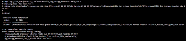

  • Hi Asha
    Here is the compile log that you asked for while running the make command "make -s BOARD=j721e_evm CORE=c7x_1 mathlib_log_testapp_freertos CPLUSPLUS_BUILD=yes"
    1. Basically the goal is to call a function mathlib_log10() that is defined in .cpp file (i.e) in the folder path "mathlib_09_02_00_04\src\MATHLIB_log10\MATHLIB_log10.cpp"  from a .c file
    This is the folder structure of my simple test application
    Its respective makefile script is,
    Additionally If I try giving this way in makefile script
      COMPILEMODE = -fg
    I am getting issues while trying to link the functions in .c file during compilation , below is the error
    Madhu
  • Hi Madhu,
    With the first error you are showing, that's the error we have been initially trying to track down.
      COMPILEMODE = -fg
    When you pass the flag in this way, is it getting passed the errors you were seeing earlier regarding building with C++. This error at least seems unrelated. Did you declare an implementation of the InitMmu function in your main_rtos.c file? This is required to set up the C7x MMU. The other examples have this function call if you need a reference.

  • Hi Asha
    As you mentioned here , the error which I am getting for InitMmu() is unrelated for the compiler issue which means I am able to pass the compiler flag as expected and I am not seeing the original issue "c7x_scalable.h requires C++" since the compiler mode is passed as -fg if I pass the CPLUSPLUS_BUILD=yes in make cmd, but some how I am facing this initMmu() issue even though I included the definition in main.c file
    Madhu

  • Hi Madhu,
    I'm seeing the same result if I compile with  make BOARD=j721e_evm CORE=c7x_1 udma_memcpy_testapp_freertos and CPLUSPLUS_BUILD=yes
    Can you try encapsulating the InitMmu function with extern "C" ? See the snippet below:
    #ifdef __cplusplus
    extern "C" {
    #endif
    #if defined(BUILD_MPU) || defined (BUILD_C7X)
    extern void Osal_initMmuDefault(void);
    void InitMmu(void)
        Osal_initMmuDefault();
    #endif
    #ifdef __cplusplus
        } /* extern C */
    #endif
    Running the above code with the command with CPLUSPLUS_BUILD=yes does not result in the linking issue for me when building the udma example.
    Asha
  • Hi Asha
    I tried encapsulating the InitMmu function with extern "C" as you mentioned. I am able to link the standard lib without any issue and also the executables got generated as expected.Thanks for the support.
