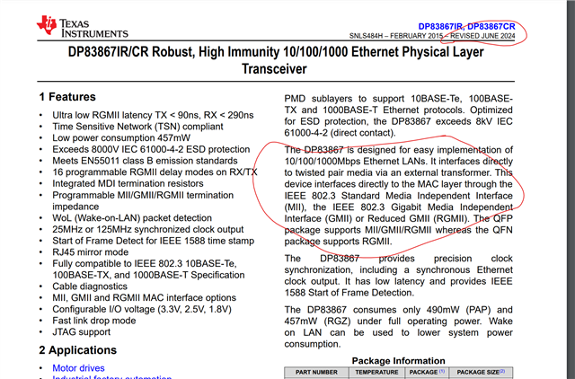

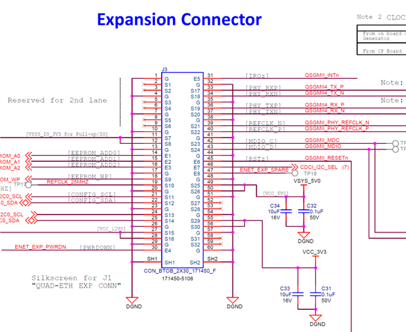

#1. Routed SGMII 5 and SGMII 6 to ENET expansion connector, but is reserved on Daughter Card, Is there a Daughter card has SGMII Ethernet PHY like DP83869 available? Customer would like to verify SGMII with DP83869 on TDA4VH.
#2. How TI verified SGMII ENET feature? especially how did TI verified DP83969 for the errata i2362 — 10-100M SGMII: Marvell PHY does not ignore the preamble byte resulting in link failure
