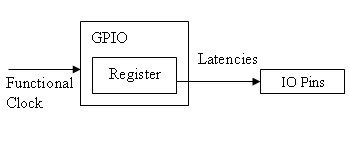

I was unable to find the GPIO toggle rate specifications for the AM3894x or AM387x int eh TRM or datasheet, what is the maximum toggle rate support?

    What ever the values (0/1) we are writing to the GPIO registers will effect on the IO pins after some hardware latency. And toggling of 1->0 or 0->1 is dependent on rise time and fall time of the IO pins.
    Unless untill we know those values we can't say a specific toggle rate.

    So if i understand your statement correctly we can change the value of the GPIO registers on every clock cycle. There is no limitation built into the architecture on this. It is just a matter of delay to the IO pins. This results in a few additional question
    • Is the Functional clock to the GPIO registers the same as the ARM core frequency?
    • Do we have any information on the latencies of the chip package for Gpio? Which could tell me the maximum theoretical effective toggle rate (to the outside of the package)
    • Do you have some example latencies from the EVMs? Which could tell me a ballpark maximum using real hardware

  • Hi Marc,
    Anil: No, functional clock rate of GPIO on AM389x is 125MHz and ARM frequency is 1GHz. On AM387x GPIO functional clock 100MHz and ARM @ 600MHz
    Anil: No, I don't have any details
    Anil: No
