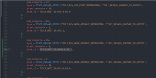

  • Hello Gunter,
    Thanks for your patience.

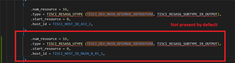

    Can you please check that the TISCI_DEV_MAIN_GPIOMUX_INTROUTER0 resource is allocated to the WKUP_R5F core in the sciclient_defaultBoardcfg_rm.c file?
    I have checked that the file does not have the TISCI_DEV_MAIN_GPIOMUX_INTROUTER0 resource allocated to the WKUP_R5F core by default.
    Please refer below screenshot.
    Please add the below lines in your sciclient_defaultBoardcfg_rm.c file if not already added.
        .num_resource = 16,
        .type = TISCI_RESASG_UTYPE (TISCI_DEV_MAIN_GPIOMUX_INTROUTER0, TISCI_RESASG_SUBTYPE_IR_OUTPUT),
        .start_resource = 0,
        .host_id = TISCI_HOST_ID_MAIN_0_R5_1,
    After adding the above changes you will need to rebuild the board config. Please run below command from the root directory of SDK.
    gmake -s -C tools/sysfw/boardcfg/ SOC=am62ax
    After building the board config, rebuild the SBL and the example project.
    Once the above steps are finished successfully, flash the EVM again with the updated images. The example should now work as expected.
    Tushar

    Note - is this a typo? is .host_id supposed to be TISCI_HOST_ID_MAIN_0_R5_0 or TISCI_HOST_ID_MAIN_0_R5_1?
    The host id for WKUP_R5F is TISCI_HOST_ID_MAIN_0_R5_1. Please refer https://software-dl.ti.com/tisci/esd/latest/5_soc_doc/am62ax/hosts.html for more info.

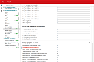

  • Hello Yue Hu,
    Just to double-check: are you booting with the SPL boot flow, or the SBL boot flow?
    Refer to https://dev.ti.com/tirex/explore/node?node=A__AZnGm6MPlXHB0zpbZBivKw__AM62A-ACADEMY__WeZ9SsL__LATEST
    To clarify Tushar's remark above, you can boot Linux on the A53s with either the SBL or the SPL boot flow, but the SPL boot flow is the default setting for our out-of-the-box Linux SDK.
    The reason we are asking is that the resource partitioning is configured in different files if you are using SPL boot flow than if you are using SBL boot flow. Tushar was discussing the files for resource partitioning with SBL boot flow above.
    Information on modifying resource allocation for SPL boot flow
    I'll attach information here in case you are using SPL boot. Feel free to ignore otherwise.
    You'll want to use the K3 Resource Partition tool to modify the default resource allocations in the Linux SDK (I assume you are using SDK 9.2?). Information on using K3 Resource Partition tool is here:
    https://e2e.ti.com/support/processors-group/processors/f/processors-forum/1308689/faq-how-to-use-k3-resource-partitioning-tool-with-processor-sdk-v9-0-or-v9-1
    Note that if you are using SDK 9.0 & 9.1, you CANNOT use the version of the K3 Resource Partition tool that is packaged in the Linux SDK. You HAVE to use the version I packaged in the FAQ.
    It looks like I haven't written steps to build the resource partitioning into the SPL boot files for SDK 9.x - let us know if that is needed. In the meantime, this in-progress FAQ has information on how I've updated the binman file to build updated DM firmware into the SPL in the past. I'm not sure how it interacts with AM62Ax firmware builder, but perhaps it will be helpful for you: https://e2e.ti.com/support/processors-group/processors/f/processors-forum/1317407/faq-am625-how-do-i-modify-the-ddr-memory-footprint-of-the-dm-r5f/5008067#5008067
    Nick

    I tried following your steps. I downloaded the k3 tool, and was able to set up the R5_1 to have 8 MAIN_GPIO_interrupt_router count (and in turn set the same value in A53_2 to 8 as well):
    I then took the output rm-cfg.yaml and replaced ours with it: ti-u-boot/board/ti/am62ax/rm-cfg.yaml
    I then rebuilt, and flashed tiboot3.bin, tispl.bin and u-boot.img. However, I still am running into the same issue. I am not sure I have set up the k3 tool right, besides changing that 1 parameter, is there anything else i need to change?
    Also, it only sets a number. How do I know which INTROUTER can be used now? The .dest_host_irq, is it 0-7, 7-15, or any as long as I don't do it more than 8 times?
    Note that I reverted the changed in sciclient_default_boardcfg.
    Can you please try running the below command and share the logs?
    k3conf dump rm 3
    The above command will tell which cores has MAIN_GPIOMUX resource allocated and the numbers also. Please refer below screenshot.
    In the above screenshot, the resource MAIN_GPIOMUX is used by A53 and M4F core only.
    For A53 -> 0 to 15 (inclusive)
    For MCU_R5F  -> 34 to 35 (inclusive)
    Tushar
  • Hello Yue,
    I have tried the SPL flow and after changing the resources in rm-cfg.yaml file, I am able to run the example.
    Below is the rm-cfg.yaml changes that I had done.
        start_resource: 0
        num_resource: 16
        type: 192
        host_id: 36
        reserved: 0
    Once the rm-cfg.yaml is changed, I rebuilt the u-boot and replaced the older tiboot3.bin, tispl.bin and u-boot.img with the newer binaries.
    Meanwhile, I have not checked the interrupt functionality but the sciclient_rmIrqSetRaw API is returning successfully.
    Please check that the resources are allocated properly to WKUP_R5F. Use the above provided command to check the resource allocation.
    I am using MCU+SDK v09.02.00.38 and Processor SDK v 09.02.00.05.
    Tushar
  • hi Tushar,
    After editing this, i noticed this now does work ok - my IRQ now is firing as expected. however what I am seeing is:
    1. When DM comes up, it properly handles the interrupt.
    2. However, after a few seconds, kernel starts, and the interrupt stops
    I believe kernel is remapping or resetting the IRQ and taking it away. I will do some testing on this today
    Unfortunately we are running our own linux build on the main core, and k3conf is not supported. I can look into this.
    Here are my changes to the rm-cfg.yaml. I gave 4 to the DM core, and 12 to the main core. It looks like start_resource is 12 for the DM core, so I am thinking the DM core can access lines 12-15, and the main core can access 0 - 11. Do you know if this is correct assumption?
    I then added a delay (to let kernel boot first, then map the interrupt) and now, everything is working properly
