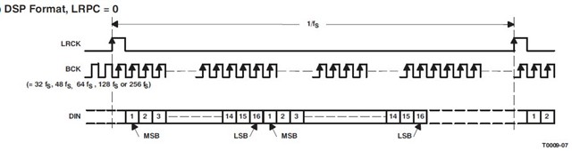

Thank for the response, now we know we can connect directly, but we don't know how to configure the mcasp to fit the PCM interface.
Our BT chip (PAN9026) just support PCM interface with DSP Format.
We configure mcasp as slave, the FRWID (rx and tx frame sync width) is set to single bit.
The clock set by the BT chip is 2MHz.
With that config the audio is still not working.

We made progressions, but it is not enough.
Setting
simple-audio-card,format = "dsp_a"; // or dsp_b
in dts we can set mcasp as DSP format, but we still get the error values. XERR (XCKFAIL|XSYNCERR)
Any ideas?

just with:
You can connect perfectly a PCM interface with mcasp.
The error flag is common in all my mcasp stream, but all of them are working perfectly.
