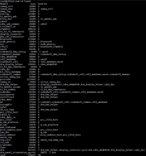

Could you share the list of modules that are currently loaded? Have you validated that the USB camera works by connecting to a PC?

Could you share the list of modules currently loaded on your device? The driver name for this camera would be uvcvideo.

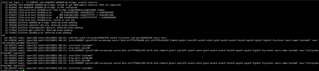

I copy boot-adas-j721s2-evm.tar.gz and tisdk-adas-image-j721s2-evm.tar.xz to my SD card, but the USB camera still cannot be recognized after booting.
tisdk-adas-image-j721s2-evm.tar.xz — 953128 K
boot-adas-j721s2-evm.tar.gz — 2298 K
There are some ERROR LOG after boot.
module list
Could you try using a USB C to USB A adapter and connecting the camera via the USB C port on the board? This should resolve the issue for you.
Thank you,
Fabiana
If you would like to use USB A, see the following FAQ: https://e2e.ti.com/support/processors-group/processors/f/processors-forum/1303008/faq-j721s2xsomxevm-enable-usb-2-0-hub-on-j7200-j721s2-j784s4
