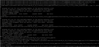

2、When I rudeced  DDR_MCU1_1 from 15MB to 8MB, I encountered  compilation error:
I reduced the other remote core memory, I also encountered the similar compilation error.

    These are basically alignment related issues.
    I would suggest following the below document to get the correct alignment
    8.9. Understanding and updating SDK memory map for J721E — Processor SDK RTOS J721E

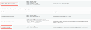

    In addition, I have another question: Which two in system_memory_map.html correspond to the ones in the following image ?
    Thanks!
